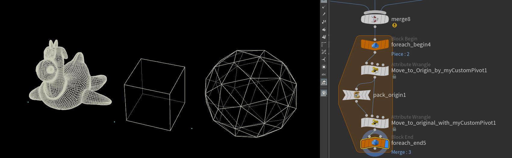

I merged 3 geos and gave them a specific v@myCustomPivot. My plan was to use this attribute to pack them with a pivot of my choosing but the Pack sop only has 2 options: Origin and Centroid. How can I pack with my custom pivot vector?

Ok, I found a solution. In my for-each-loop, I move the points with my v@myCustomPivot vector, I pack (with origin option) and finally, I move it back to its original position.
My first wrangle is:
my second wrangle is:
int ptprims[] = pointprims(0, @ptnum); //myCustomPivot is stored on prims vector myCustomPivot = prim(0, "myCustomPivot", ptprims[0]); @P -= myCustomPivot; setdetailattrib(0, "myCustomPivot", myCustomPivot, "set");
vector myCustomPivot = detail(1, "myCustomPivot", 0); @P += myCustomPivot;
