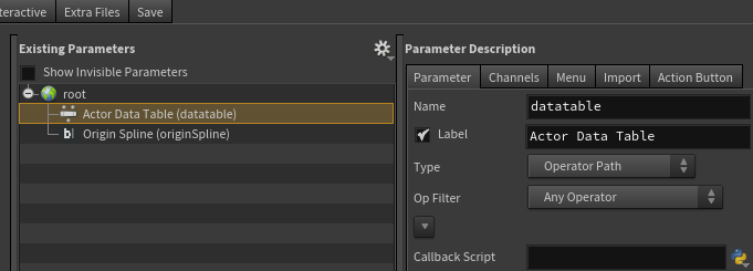

Hello!
I am using the Data Table to keep some values for HDA.
This data is parsed in Python node and works OK.
But now I would like to automate setup in Unreal.
One little thing stops me: how can I setup Operator Path parameter or use it as Input?
Thank you in advance!
Vlad

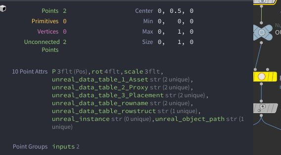

Just in case if anybody need it, solution is to create the Geometry input and set Data Table to it. Not as parameter.
