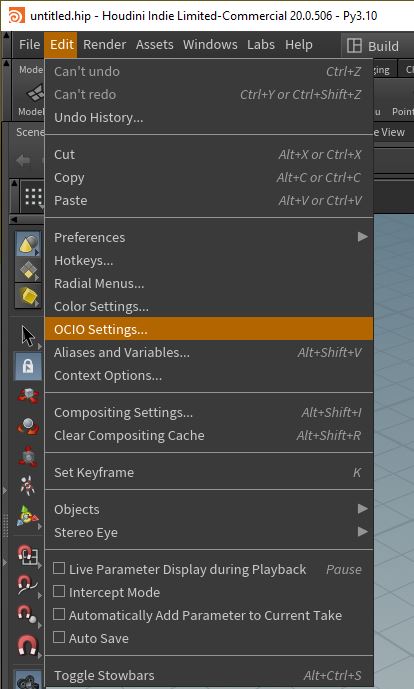

What is that menu in the bottem left in the first screenshot and how do you acces it ?

NicTanghe
