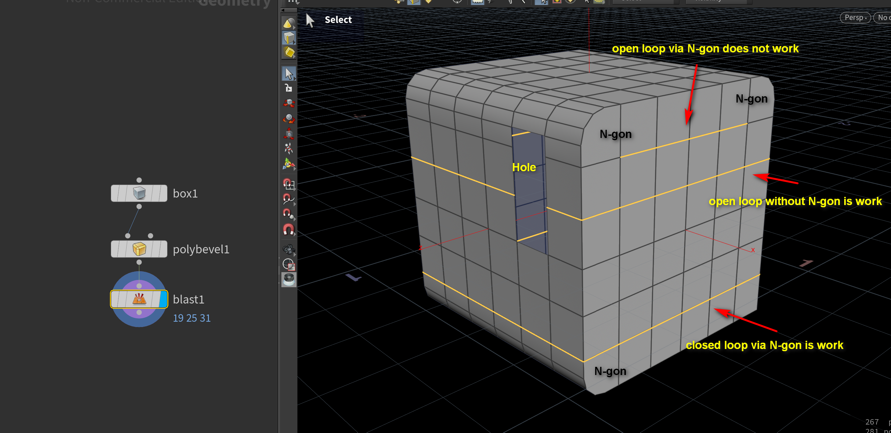

You should try to select the ring from the edges on the pig using double-click MMB or using the "A" key, in the area between the green stripes as in the screenshot. Is it working out or not?
And select the loop on the cube as on the screen by double-clicking LMB starting from any marked edge. Does not work ? What if you disable blast ? Works ?

Both selections don't work. Probably because of the presence of certain types of poles Houdini finds on its path. But I'm not sure why the selection in Houdini aborts completely, ergo: no edges are selected at all. In other software when I make this selection at least I get a selection of edges between ambiguous areas.
Interactive loop/ring selection in Houdini was always somewhat... um.... capricious? For the lack of a better word.

You can implement edge loop selection with this behaviour using VEX (Detail Wrangle):
function int [ ] GetPrimsFromEdge ( int input; int pt0; int pt1 ) { int prims [ ]; int hedge = pointedge ( input, pt0, pt1 ); if ( hedge != -1 ) { int count = hedge_equivcount ( input, hedge ); for ( int i = 0; i < count; ++i ) { int pr = hedge_prim ( input, hedge ); if ( pr != -1 ) { append ( prims, pr ); hedge = hedge_nextequiv ( input, hedge ); } } } return prims; } int GetNextPoint ( int input; int edgept0; int edgept1; int currentpt ) { int ptneighbours [ ] = neighbours ( input, currentpt ); int primpts [ ]; int prims [ ] = GetPrimsFromEdge ( input, edgept0, edgept1 ); for ( int i = 0; i < len ( prims ); ++i ) { int count = primvertexcount ( input, prims [ i ] ); for ( int f = 0; f < count; ++f ) { int vertIndex = vertexindex ( input, prims [ i ], f ); int pointIndex = vertexpoint ( input, vertIndex ); append ( primpts, pointIndex ); } } int uniquepts [ ]; foreach ( int pt; ptneighbours ) { if ( find ( primpts, pt ) < 0 ) append ( uniquepts, pt ); } if ( len ( uniquepts ) == 1 ) return uniquepts [ 0 ]; return -1; } void GroupEdgeLoops ( int input; string edgegroup, groupname ) { if ( edgegroup == "" ) { setedgegroup ( geoself ( ), groupname, 0, 0, 0 ); return; } int loopedgepts [ ] = { }; int edges [ ] = expandedgegroup ( input, edgegroup ); if ( len ( edges ) == 0 ) { setedgegroup ( geoself ( ), groupname, 0, 0, 0 ); return; } int count = int ( 0.5 * len ( edges ) ); for ( int i = 0; i < count; ++i ) { int edgepts [ ] = sort ( array ( edges [ 2 * i ], edges [ 1 + 2 * i ] ) ); int index0 = find ( loopedgepts, edgepts [ 0 ] ); int index1 = find ( loopedgepts, edgepts [ 1 ] ); int edgefound = index0 % 2 == 0 && index1 % 2 == 1 && index1 == 1 + index0; if ( !edgefound ) { for ( int c = 0; c < 2; ++c ) { int points [ ]; int pt0 = edgepts [ c ]; int pt1 = edgepts [ 1 - c ]; int currentpt = pt0; int lastPoint = pt0; append ( points, currentpt ); int nextPoint = GetNextPoint ( input, pt0, pt1, currentpt ); while ( nextPoint != -1 && nextPoint != lastPoint ) { pt0 = currentpt; pt1 = nextPoint; currentpt = pt1; append ( points, currentpt ); nextPoint = GetNextPoint ( input, pt0, pt1, currentpt ); } int ptcount = len ( points ) - 1; for ( int f = 0; f < ptcount; ++f ) setedgegroup ( geoself ( ), groupname, points [ f ], points [ 1 + f ], 1 ); } setedgegroup ( geoself ( ), groupname, edgepts [ 0 ], edgepts [ 1 ], 1 ); } } } GroupEdgeLoops ( 0, chs("group"), chs("vex_selectiongroup") );

дождевикYes, I reported it. But they don't want to fix it, as I understand it. C'est la vie. Although I believe that such ridiculous bugs in the most basic things greatly spoil the reputation of programmers. You can understand bugs in complex algorithms, but not in basic tools.
I agree this behavior is nonsense. Ngons shouldn't change how edge loop works. Is it reported?
