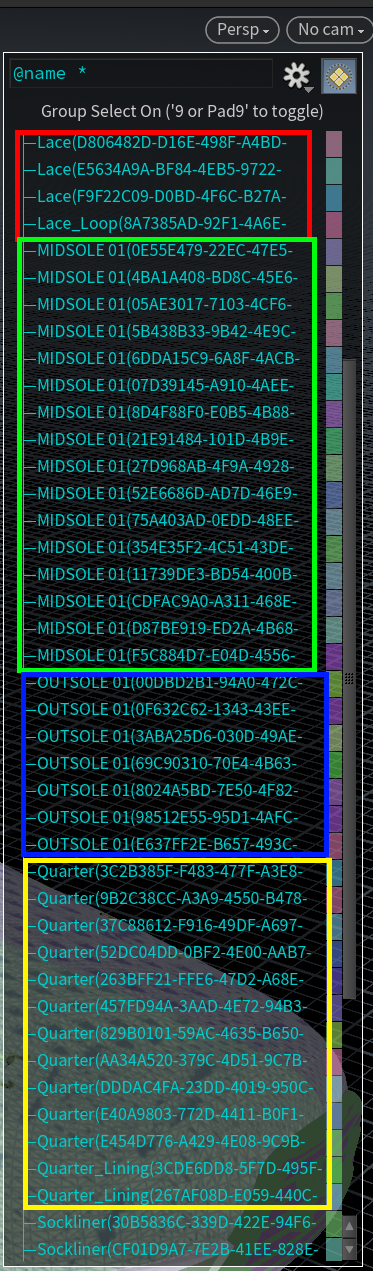

Not sure if I my ask is using the correct description. Hopefully the image will help explain. I am trying to run a for each over geo that has a bunch of names. Or create groups from each common name block, and then be able to run a for each group etc. The names have common syntax but are not identical. So instead of having 4 "Lace" names I'd love to figure out how to group them to 1 "Lace" group.
Another issue is that I'd like to be able to do this with out knowing what names are present. I know that I can create groups if I already know the partial name, midsole, lace etc. using something like "@name=*ace*" But if I don't know those names. Is there a way to find the common name string and group them.
I hope this is making sense.
