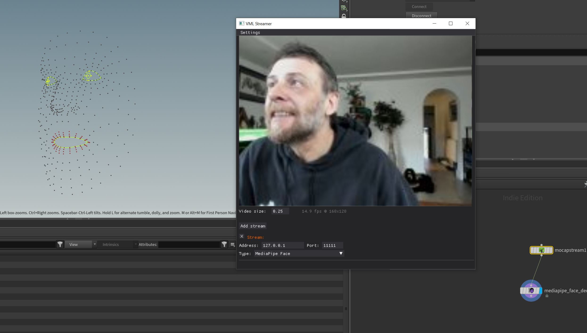

A quick face rig test.
Google's MediaPipe won't export true 3d world coordinates, as it is mostly targeted at mobile stuff (filters, overlays, etc), so there are some distortions (think of it as a 2.5d tracker). Also this is definitely not a replacement for other facial mocap solutions.
But I believe in its potential for a region based driver, like adding some life to the eyes, etc.
It is also realtime, easy to setup and doesn't rely on fancy hardware (just simple monocular webcams), which is a nice environment for quickly prototyping stuff.
The example below was captured on a logitech C270 (720p) webcam, and the motion is recorded using the Mocap Stream built-in recording system.
The output of the recording is a motion clip, but since it is still a byte array (not yet decoded by any VisionML node), it can't make use of the nice motionclip nodes (retime, etc). But as soon as the motionclip is evaluated and converted into points, one can use timewarp or chop nodes to massage the data.

- VML Streamer now starts in the "no video" mode. its faster if all you need are video files, no webcam is loaded.
- Video capture API is exposed in the main menu. (Windows: Direct Show is faster, but doesn't work with all video sources!)
- Added "Video Size" control, so you can resize video before sending data through streams (and trackers). (This can help with general performance/avoid crashes on large resolutions). *Note: always prefer downsampling directly at the webcam driver if possible (example: camo studio has controls for setting resolution), this will help even more with performance.
- Removed fps info overlay from video feedback, and added as a simple UI text together with current stream video resolution. Also helps with performance and info does not get in the way.
Thank you guys for your feedback! Let me know how it goes now.

Hey! new version tested on windows. Body tracker now works!
I was setting / testing it originally on the one single stream, first load no other streams, on the previous version and I was getting a wierd signal like what Oliver had, but now it works! it takes longer for default first instance video to kick in now, maybe over 10 seconds once Ive selected the web cam, previously it used to be instant. not a problem though actually as setting to 'Direct Show' before selecting the webcam it appears instantly as before.
video window is bigger now though which is good.!
Also I forgot to mention previously that adding the face tracker (again no other streams and first time per instance) previously just closed down the VML Streamer, and it still does the same thing with this version. I see on your demo you used a video file rather than the web cam maybe I should record a video and test as before when I selected video file it crashed also. - aaand just tried on this version. I record a video with my web cam, (MP4) select it with the file browser in the VML streamer then it just closes down the streamer
Edited by Rob Chapman - Jan. 19, 2024 10:02:39

Hi Rob, thanks for the feedback!
Good to know video is more reliable now. (And yes, direct show it much faster! if it works for your webcam device, turn it on at the start). Note that dshow can crash while loading video files thou, that's why I didn't make it default anymore!
For face tracker, can you please try recording a quick 5-10 sec video and resize it to something small like 300 px wide. See if that works. (I'm just trying to eliminate that the crash is related to your specific OS/webcam versions or something).
If that works, I probably need to touch code for performance once again (even more on windows, since the trackers are not gpu accelerated). There might be just too much data being passed over at the moment. For now the workaround is to simply use smaller videos (or the video resize box).
As a benchmark, these tests on my release video were made in linux, reading from a logitech c270 webcam directly in 320x240px (ie: no video resize, just plain smaller resolutions direclty from the device). That's the best approach, but rather complex to support in all available resolutions from most of drivers in Win/Linux. But its on my radar for future updates.

Hi again! Thanks for the update, CAMO now works beautifully BUT I cannot track the face. Body works fine and hands work fine, but when selecting MP Face the image from my cam turns black and stays that way or other times it just crashes VML!
Again, thanks so much for bringing us these tools, I know time is hard to find so I am really appreciative of all that you have already done! Any idea of what it might be, maybe I can check on my end?

Hey Fabricio , yes, If I set the video settings on the capture on the BRIO down to 120P 30fps (640 x 480) and it still crashes. BUT if I set the video size in you VML window settings to 0.5 or 0.25 (320x240) or (160 x 120) it does not crash! live video is working at this size with Face tracking enabled. whilst I do get video working and even when my face goes out of camera it freezes the video but bring my face back in the video restarts fine BUT im not getting any tracking data or face lines overlay like it does with body and hands.. so indeed the smaller size is helping it not crash , but maybe my face (and beard) is too tricky for it to computer perhaps. IU'll try the missus, she doesnt have a beard
UPDATE didnt work with my better halfs face either... BUT I looked at your setup video and it wasnt overlayed on your VML streamer window either! so I did the mocap stream > mediapipe face decoder node setup in houdini and et Voila! works beautifully! with live video. this was 160 x 120 really good and fast update and not too taxing on my RTX 4070 GPU either - just tried 0.5 (320 x 240) refresh is not as quick as 0.25 but its still quick and not too taxing and also works! nice One Fabricio!

Hey guys, just a quick update to let you know that I've probably found the culprit of so many the crashes. This likely comes from bugs in the UI module itself (its based on a python port of imgui), so I'm rewriting the entire app in QT now with some added features (auto-detect webcam devices names and resolutions, much faster webcam start times, etc).
Also on this new version we can get the frames at different resolutions directly from the driver (ie: no post image resize!) which also improves performance a lot! Another performance gain comes from the fact that QT is signal based, as opposed to the previous UI which is event loop based, so it means there is zero chance that media pipe runs the detection over the same frame twice.
Anyway, this is looking much better and more responsive overall (I tested with a simple webcam, camo studio+phone cam, obs virtual cam). But since its a complete rewrite, I'll need a couple more days to finish implementing everything.
I'll send new links when done. Again thank you for all the feedback, much appreciated!

It's you who should have the thanks, this is opening up so many possibilities I feel, even if it isn't state of the art mocap it can still probably get the job done for smaller task - which is still much more opportunities then we had before! Can't wait for the update!
