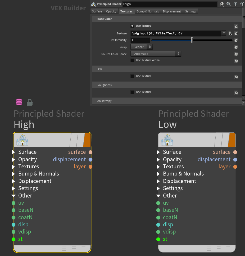

I'm quite new to this... I can't get the maps baker to output baked textures...
I've got a bunch of hi meshes, with awful textures, and my goal is to polyreduce them, autouv, export the lowpoly and bake a better-looking texture.
Everything worked until I've dove into TOP's. Got it doing the first half (polyreduce,autouv,export lowpoly), but I got stuck when baking out new maps. they just won't appear in the folder. i know I'm screwing something up, but I just cant wrap my head around what exactly I'm doing wrong... attached the file.
Thanks for any help!
Experiment_v2.hiplc (526.1 KB)
