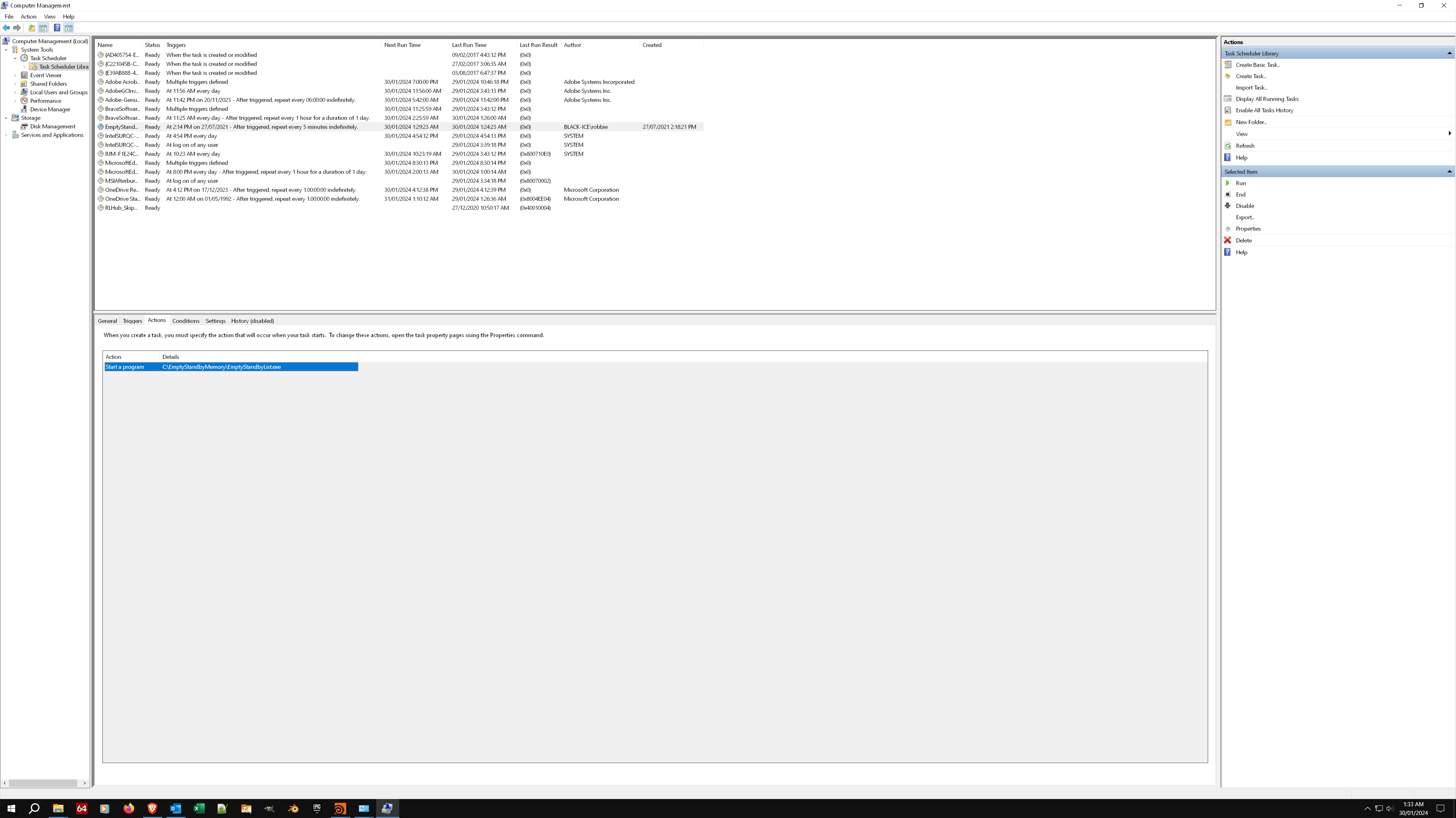

this is what I have for you Empty standby memory every 5 mins just can't remember how I changed it
Perfect I just do it and it delete the cache in the task manager it doesnt release the commited memory, im checking if this make the render faster, thank u!

https://youtu.be/ajKQB0SBs2I?si=t4EIAZG5Llgo77QN [youtu.be]
the link looks like what I did. I can't remember downloading anything but. I do see a program listed
