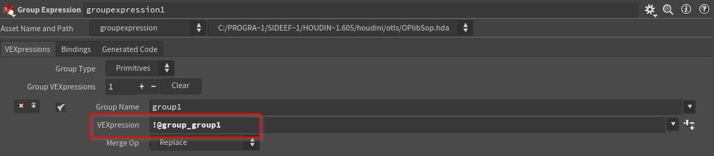

Group Invert Sop is new to H20. So you can use then the group expression sop:
