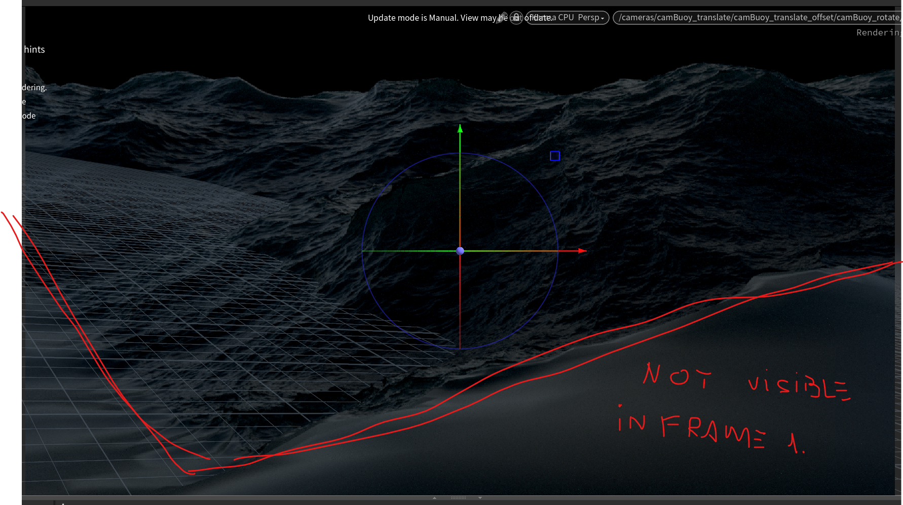

Maybe it's not same cause, But I'm also having issues with Ocean procedural.
I have camera that is animated and ocean. During test renders (with static camera) everything was peachy. I fine-tuned my ocean and rendered several previews, nice.
Now I animated the camera, and suddenly I realized that the renderer is using the camera position from frame 1 for dicing for all frames.
I tried with a camera from USD, recreated the camera in solaris, nothing works. I always get dicing only in areas visible in frame 1.
Tom Vujnovic

Undelyng ocean surface is animated, and he suggested that instead of exporting one spectra for the whole animation, I should export a sequence of spectras.
I'm not sure if that is the case, but I'm testing it now.
If that does not work, I will share my scene gladly.
