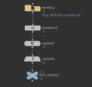

Hello,
I'm a newbie but I've create an Attribute Paint and hit Enter in the viewport and the brush doesn't even appear.
I also get this error when I want to add a new attribute "AttributeError: 'module' object has no attribute 'updateattribute", but I would honestly just be happy to have the brush appear.
Let me know if there are any suggestions, thank you.
Edited by Alexandra_Chiosa - June 4, 2024 12:50:19
545 posts
Joined: Nov. 2016
What is your input geometry?
23 posts
Joined: May 2024
Tanto
Hi,I am using an alembic but reference it with a Object Merge if that makes sense.
Edited by Alexandra_Chiosa - June 4, 2024 10:59:09
545 posts
Joined: Nov. 2016
Is it possible your Alembic is still packed? If so you won't have access to the geometry (the rest of the setup won't work correctly either). Try to use a a convert node after the object merge.
23 posts
Joined: May 2024
Tanto
Before the screenshot I showed, I have a simple setup for my alembic (which I reference in Object Merge node) and I already have an unpack and convert node. Not sure what else would work in this case.
545 posts
Joined: Nov. 2016
You're right, that should do the trick. If you can send your hip file it'd be helpful to figure out what the problem is.
23 posts
Joined: May 2024
Tanto
Yes sure. Let me know if I can provide anything else.
Edited by Alexandra_Chiosa - June 4, 2024 11:40:35
545 posts
Joined: Nov. 2016
Your setup seems fine. I don't have the alembic file, but substituting it with a random one, I was able to paint without a problem.
In this thread [www.sidefx.com], somebody with a similar problem seemed to be able to fix it by using the numpad enter, you might want to try it. Otherwise, updating your driver to one supported by SideFX [www.sidefx.com] might also be a good idea.
23 posts
Joined: May 2024
Tanto
Amazing, thank you for having a look! I will check the links. Also may I ask what Houdini version did you use to check the file?
545 posts
Joined: Nov. 2016
Sure, I'm using 20.0.688
23 posts
Joined: May 2024
Tanto
Thank you! Also just as an update, sadly the numpad enter key didn't fix it either, so any other suggestions from anyone in the future are always appreciated, thank you.
23 posts
Joined: May 2024
Tanto
Just to let you know (even if it's not interesting) I tried using Houdini 20.0.688 instead of an older one and it works! I suppose the node is not working for some reason in earlier version, thanks again for having a look!

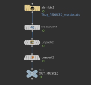

Here's the setup:
