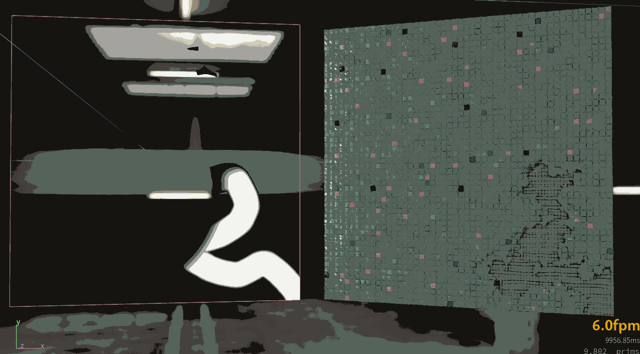

Hi 9of9, I am not sure if I am doing this right, but I have tried this:
- open the file as it is
- set the display flag to /obj/Texture_Mask_Paint/merge1
- set the brush to Erase on the /obj/Texture_Mask_Paint/texturemaskpaint1
- hit Enter in the viewport to start the Paint tool
- (for some reason the painting transform is reversed, but I don't investigate)
I am getting ~4 fps, as in the gif
My specs:
- gpu: 4090
- cpu: intel i9-12900K
- windows 11
- nvidia drivers: 560.70
If you want to reach support, I can give them my Houdini_Info.txt file (Help>About>Details)

ikoon
That is far more reasonable than my results! Will try to attach a video. Your frame time looks to be about 230ms on average - mine is about 1650ms if following those exact steps, so that's a 7x difference!
While 4fps is low, that does look closer to what was demoed and is at least somewhat usable - I can see that being something that could be optimised down across the specific nodes, but I can't see a way for me to claw back ~1400ms of frame time as it stands!

I watched my GPU and CPU usage. CPU goes to some 11% (probably single core full load). GPU goes to 70-90%
Single core performance of that i9 may be 60% higher than Ryzen's. I am not sure where else might be the difference. Maybe try to update the nvidia drivers too. (I have the Studio Drivers 560.70)

That's a good shout - upgrading to the latest 560.70 driver, whether Game-Ready or Studio improves my frametime to about 850ms on the 4090, approximately halving it (and still over 1200ms on the 3090!). Though that's still almost four times slower than yours!
My GPU utilisation is about 90-100% while painting, whereas CPU remains steady at 5%.
