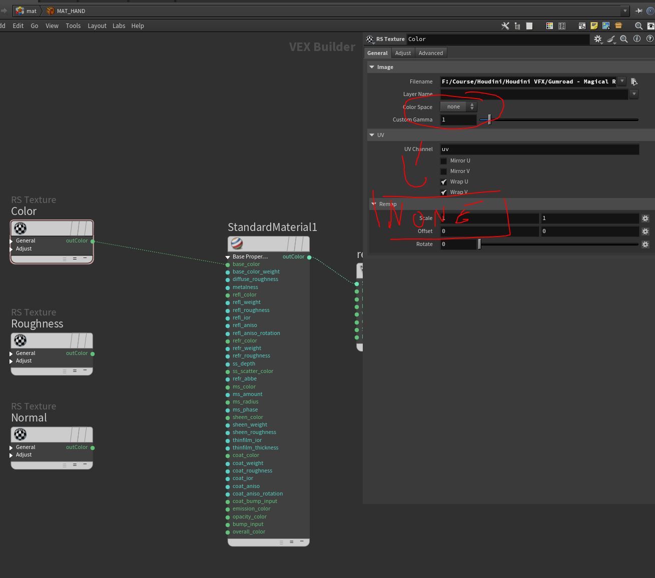

hello, I can't change the colo space from RS texure.
I have just "none" in the clor space tab.
Do you have an idea plz?

Hi!
Probably you are using the OCIO config file that comes with Houdini 20.5 which is not compatible with Redshift right now because it is OCIO 2.3 and RS works with OCIO 2.1 until RS 3.6.04. You can use the Redshift build-in ocio file or the ocio custom config from Saul Espinosa.
