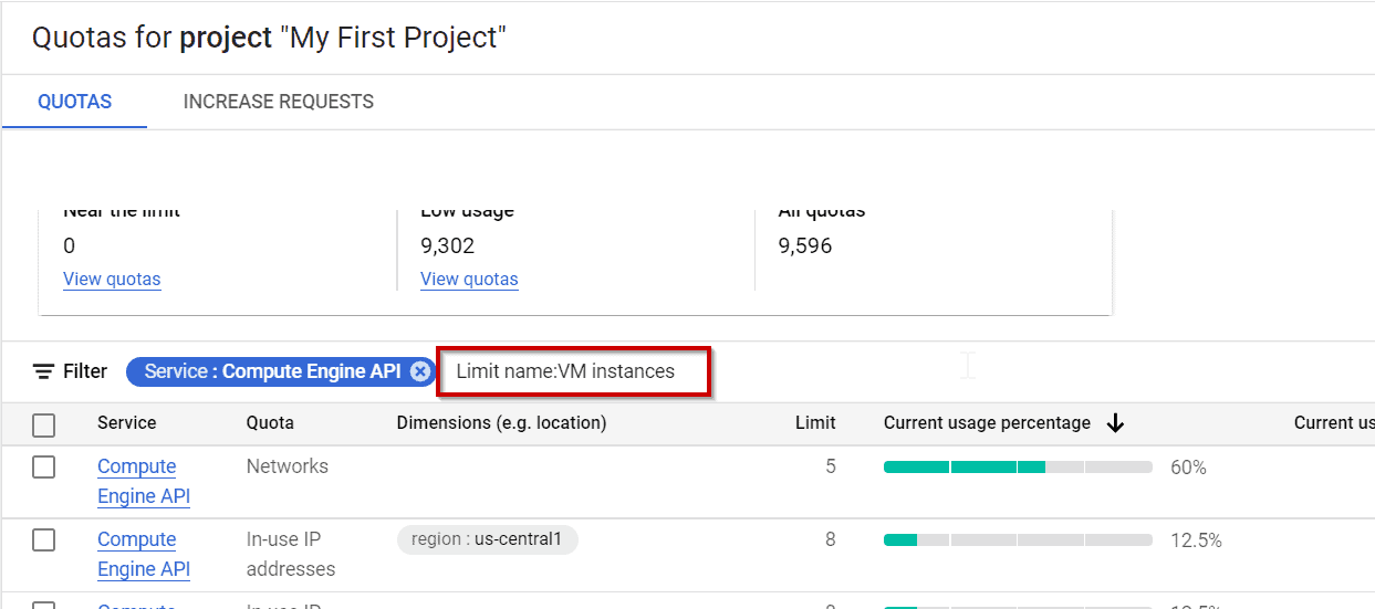

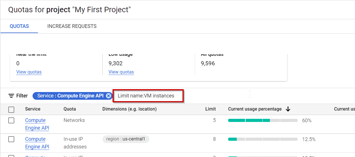

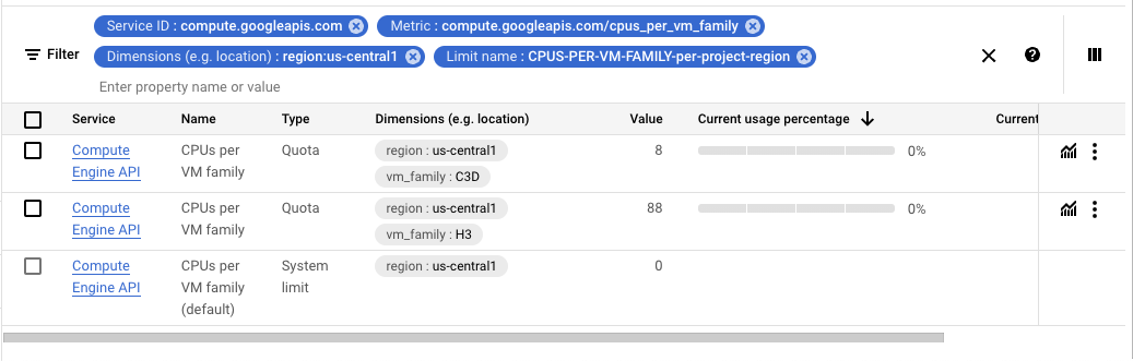

If long list is a problem mayby there should be search feauture for it? Also Search feature with adwanced filtering option where you can type keywords and make them pernament (as UI buttons) and combine keywords using logic operators fe. (capt) (_23 - _45) (r)
I saw such filtering on google website where a lot of data was listed and it worked fine. It could be shown in UI as pushable rectangles so you can quickly make them ON or OFF for faster filtering once you make them by entering keyword.

448 posts
oldteapot7
Surely, at this point, you would switch to the Geometry Spreadsheet, that has filtering and sorting built-in? The info dialog is meant for a quick glance overview, I'm not sure that bloating it with fringe functionality is the way to go.
