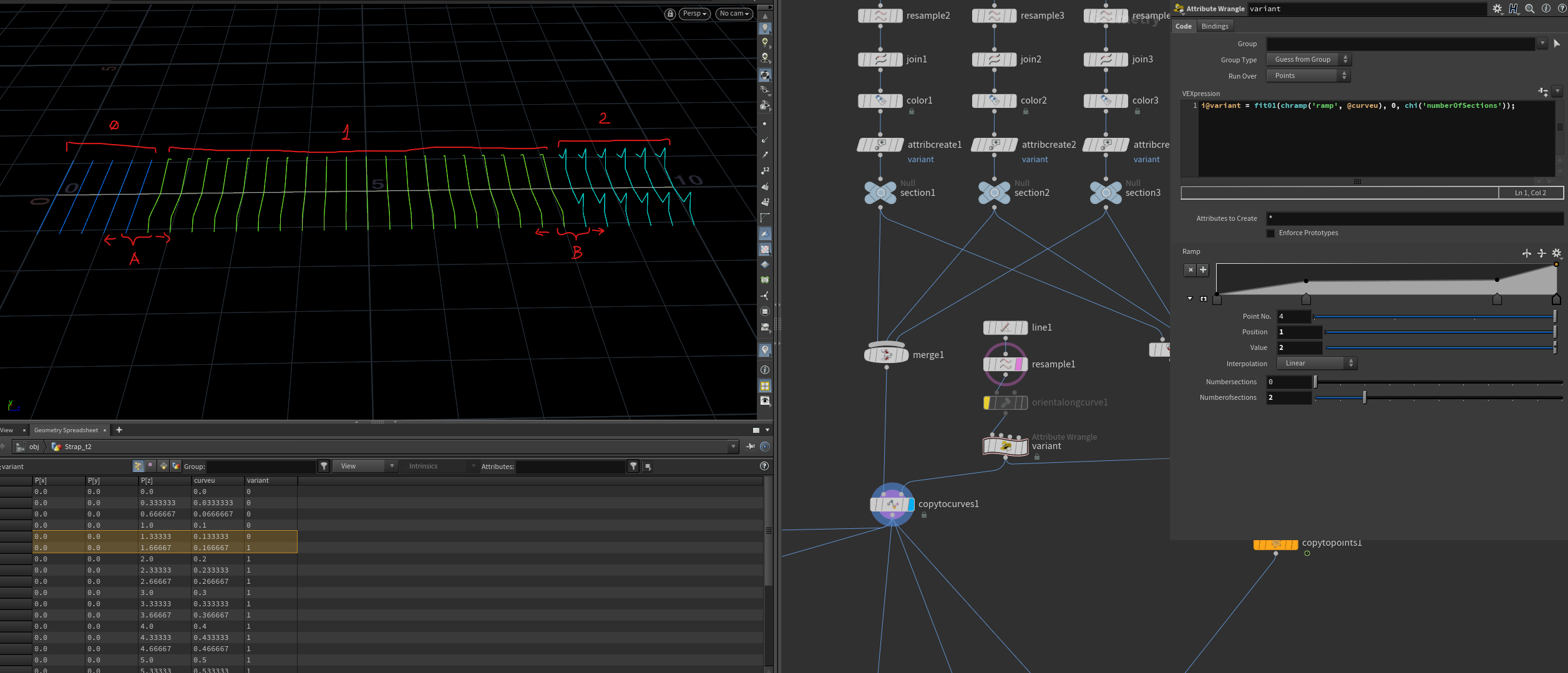

Someone have any proposal to set an interpolation for curves between variant attribute?. I have tried by selecting first/last primitive of each group (@variant=0, @variant=1, @variant=2) then removed them, but I can't find how to create interpolated curves between them. The idea would be to have also a bit of control for the amplitude of that interpolation (A - B)

I have done this approach in order to get some space for interpolation between curves worked as cross-sections. This is not working so bad for my purpose, in fact using a blendShapes SOP I have getting exactly the average curve at 0.5, so in theory I have not needed cross-secction for interpolate the skinSOP. However ideally I would like to have a tangency or curvature control in A/B space.

Both, skinSop or sweepSop (using variants) seems not compute the interpolation between cross-sections.
