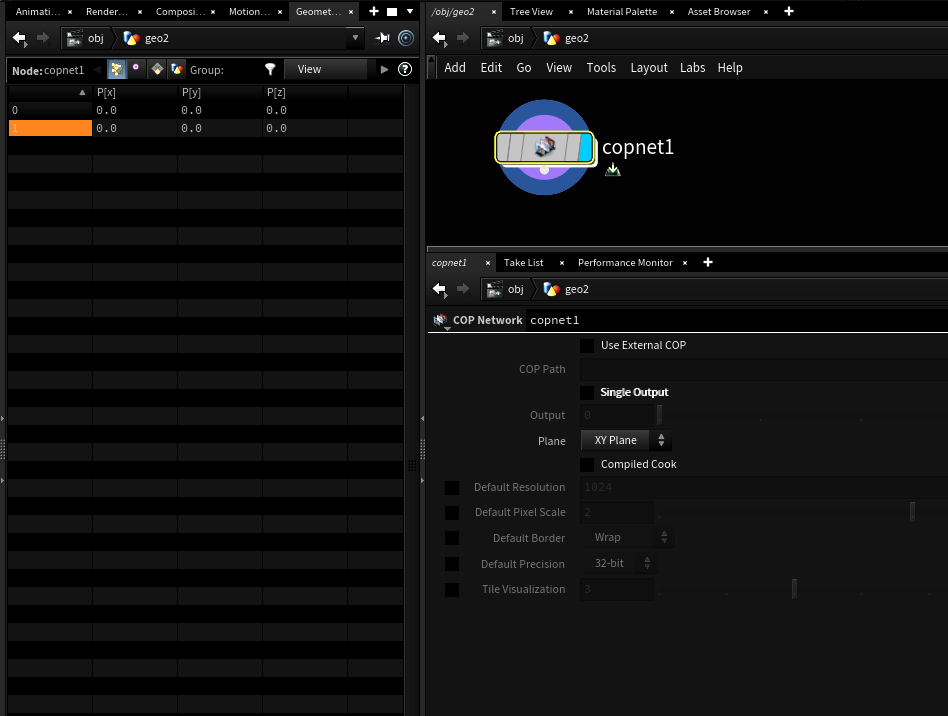

Ok here is what I found:
There are two ways to output multi-outputs.
1. The Output is for Subnetworks in the COPs.
2. NULLS provide outputs
3. Set either output parm or output multiple.
You can see that with the "Single Output" off you get 2 Prims overlapping each other.
Otherwise you can toggle the Output with the slider.
Edited by PHENOMDESIGN - Aug. 1, 2024 18:31:06
Screenshot 2024-08-01 at 6.24.35PM.png (32.8 KB)
Screenshot 2024-08-01 at 6.25.28PM.png (71.2 KB)
Screenshot 2024-08-01 at 6.25.40PM.png (69.2 KB)
