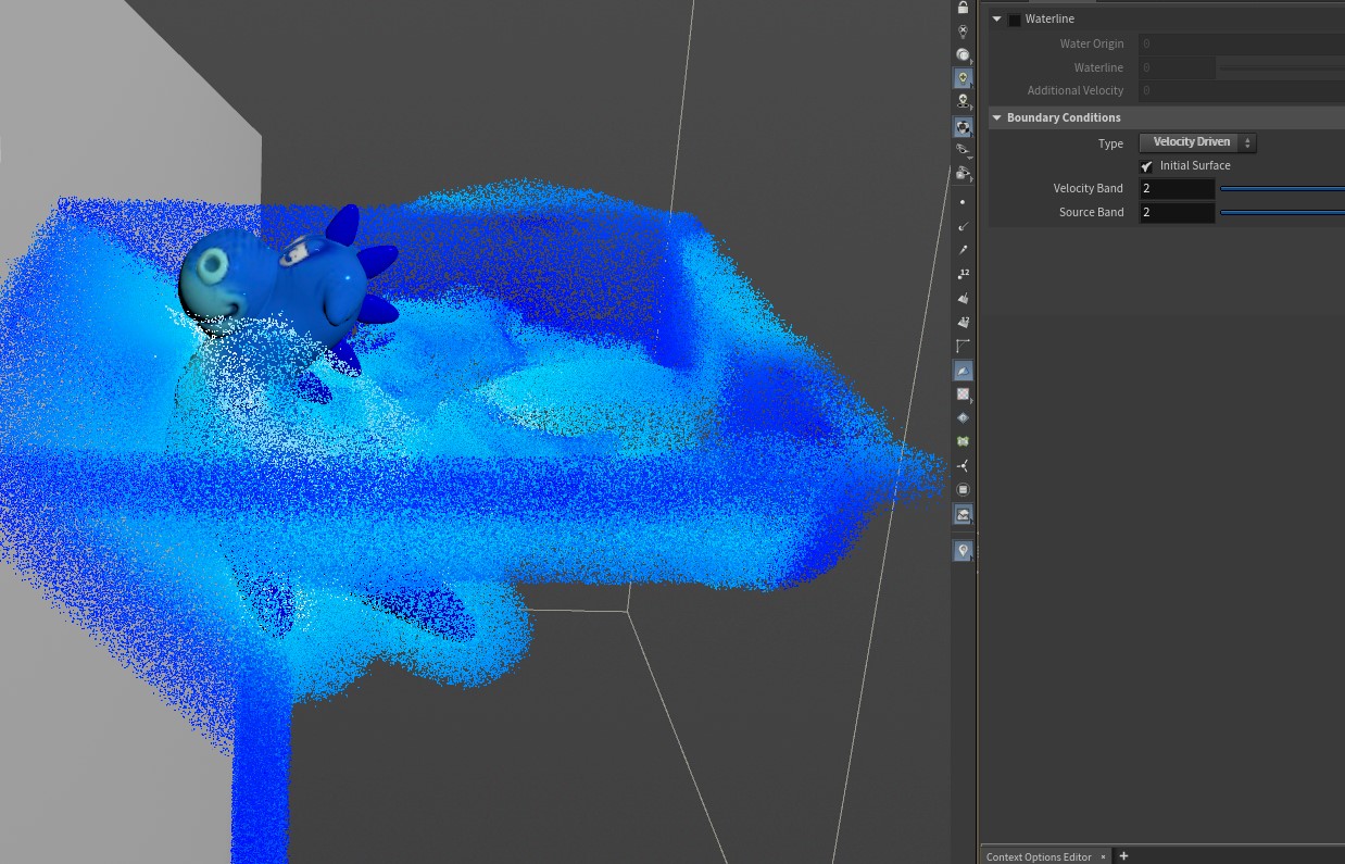

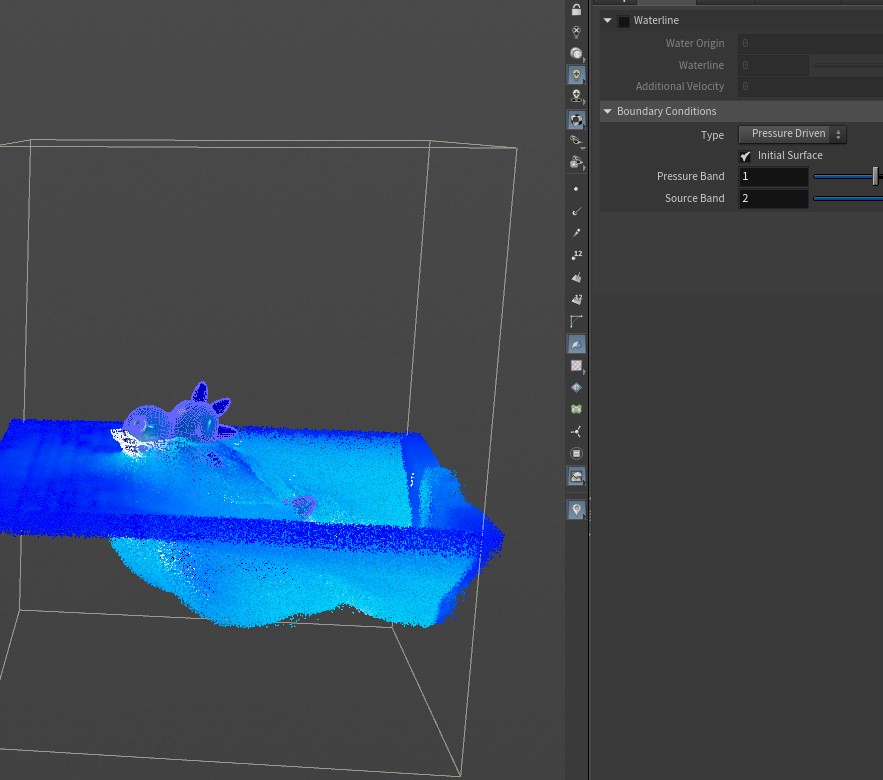

I'm trying to follow Igor Zanic's sop flip upres workflow outlined in his BGHUG talk (https://youtu.be/merqe0uYrKM?t=857). However, my hi-res flip sim loses volume. If I try the Pressure Boundary I lose volume immediately at the beginning of the shot. If I try the Velocity Boundary condition, I lose volume toward the end of the shot.

Edit: Using the velocity boundary method, from what I can tell the majority of the volume loss begins the moment the sim bounds encounters the ground collision geo.

It took me all day but I think I figured it out. My issue before was that my hires container bounds at times would leave the bounds of the lores, especially at the bottom of the tank and near the collision beach. However, I have adjusted my hires bounds to remain within the lores bounds and it fixed everything. I can now even use the Pressure boundary setup and I'm getting better results.
