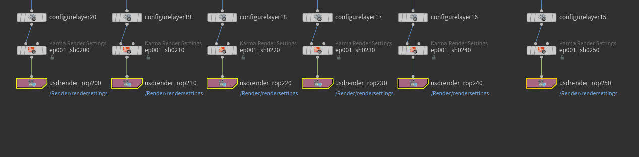

Yea wasn't focusing on that part, here are screen shots of process.
Nothing special at all just Karma render ROPs, latest deadline.. that is all... all vanilla.
