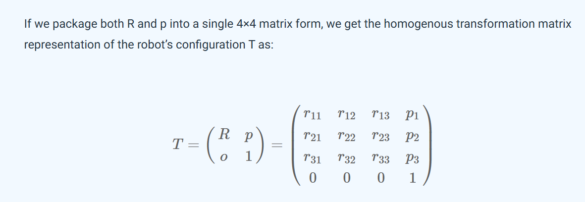

The localtransform is a 4x4 homogenous matrix (which can easily separate the rotation matrix from the translation vector) according to this website/ documentation "https://mecharithm.com/learning/lesson/homogenous-transformation-matrices-configurations-in-robotics-12 [mecharithm.com]"
In this case, the rotation matrix extracted (lets call this M0) would be a (3x3) from r11 to r33 in the picture. However this values are local to parent values instead of local to world space values (which i want).
