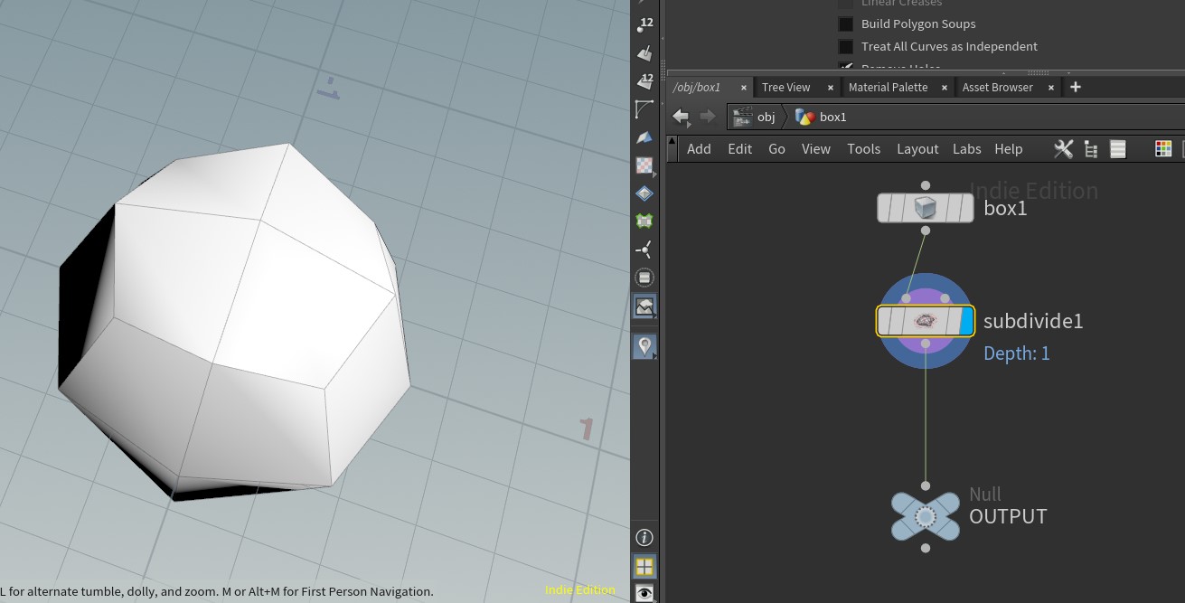

In Houdini, when the Tab menu is open, we can press Shift+Enter to insert the node and it'll be automatically connected to the current seleted node. Which is great.
But my question is: how to insert it between the current node and the next node?
For example, I have this setup:
Now I want a Normal SOP between Subdivide and the Null:
But if I press Shift+Enter, Houdini adds the new node like this:
It looks fine at first glance... but it's not! The Normal SOP is NOT connect to Null!
I know I can just drag and drop it, but this kinda defeats the whole point of using Shift+Enter in the first place...
Is there a hidden shortcut that I'm unaware of? Like Shift+Enter but insert the new node between two existing ones?

The only way I know how to do this specific thing (disclaimer: I sometimes do not know things) is to not select the node you want it inserted after, but to right click on its output, which opens the tab-menu, select or type subdivide, and then press enter twice.
So no keyboard only method.

Another way is to select the wire, then add the node with Tab > (node) > Shift+Enter.

Thank you guys. I didn't even know the wire is selectable I always use Y to delete wires.
