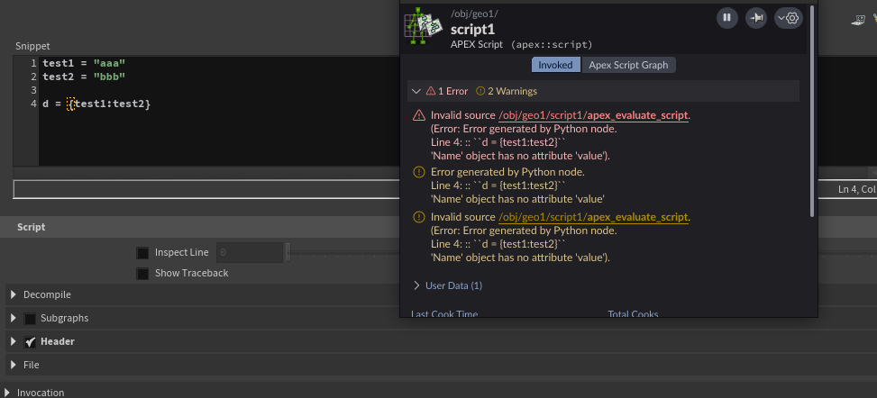

Hello,
i am trying to set a dictionary Key with a Variable i defined and it yields me an error as you can see in the following screenshot:
Any ideas what is happening and how i could work around that issue?
Thanks,
Dani
13 posts
Joined: 5月 2018
Okay got it, in case someone else also stumbles on this, here is the syntax that works:
スタッフ
196 posts
Joined: 1月 2024
you can use set as well
test1: String = "aaa"
test2: String = "bbb"
d: Dict = {}
d.set(test1, test2)
