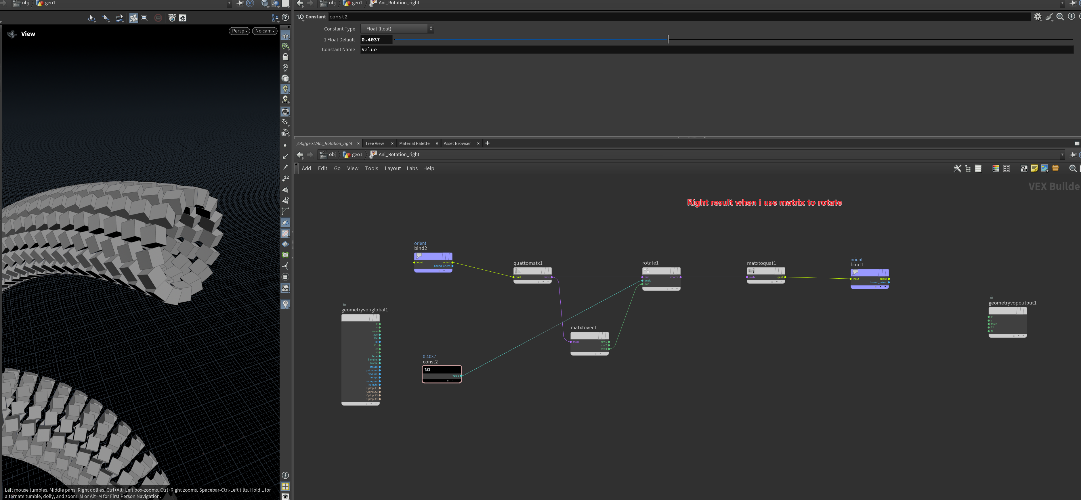

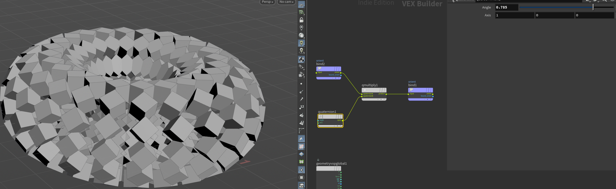

I wanna rotate my each cube with the axis 'N'
I get the right result through Matrix but the wrong result through Quaternion
why?
how to use the way "qrotate()" to get the right result?
Right result when i use matrix to rotate:
Wrong Result through the ways of Quaternoin:

Hey jackdon4682!
you don't need the qrotate node and you are loosing information converting your quaternion to a vector and back.
Instead use quaternion multiply to rotate your orient by another quaternion.

Damn, you're so good! I was struggling with the qrotate node and got the information wrong.
I can't thank you enough for the crystal clear explanation!
