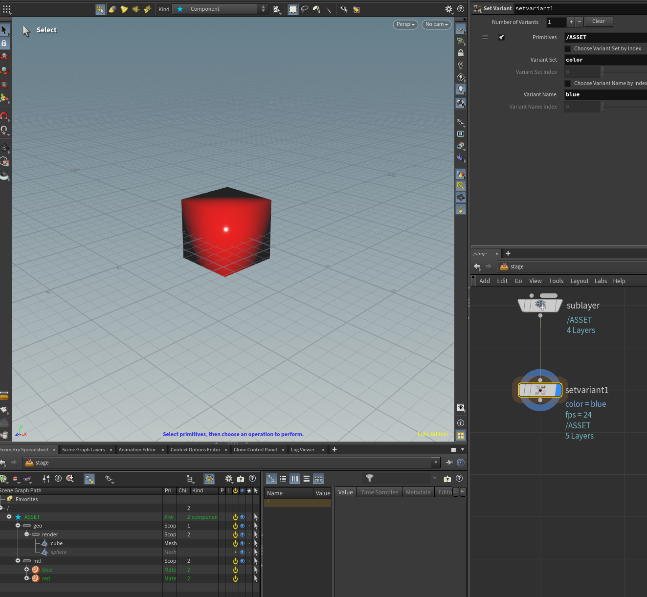

Is this another question about sublayers vs referencing? Maybe. But I have yet to see this exact issue addressed.
I'm not understanding why I'm seeing a difference with variants specifically with material overrides between sublayering usd files and referencing usd files.
For this example, I have 4 usd files that assemble into an asset.
I have a cube and a sphere in a geo.usd file
Next, I'm referencing that into a new file, and pruning out the cube or sphere depending on which variant is active.

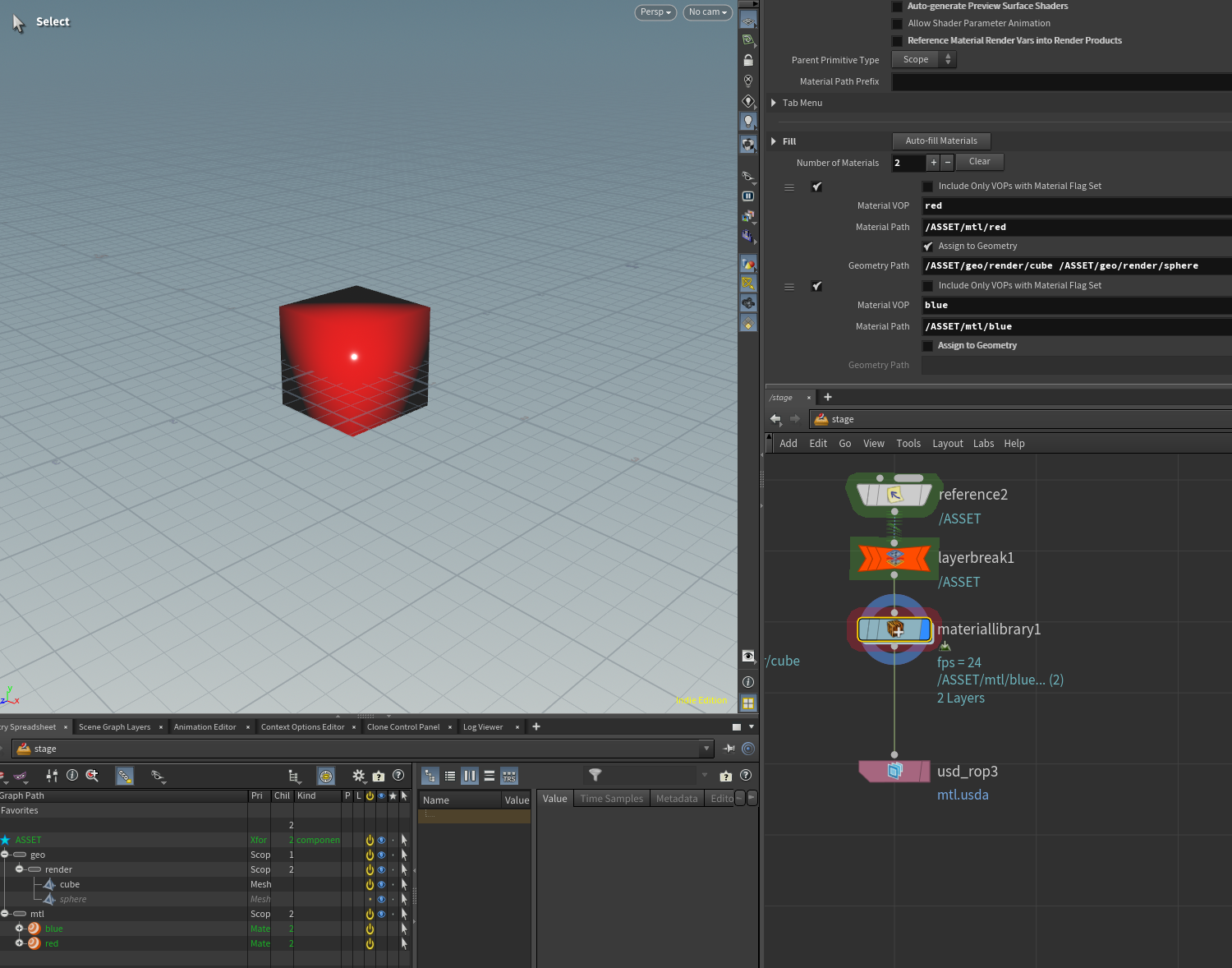

Next new file I'm creating 2 materials (red, blue), and assigning them to the geo.
My next file, I'm creating a variant where I apply the blue material and set the blue variant.
If I reference all 4 files into my stage/root layer, everything works as expected. However, if I sublayer all 4 files together, the blue variant is ignored, and I can't switch the variant in my scene graph.
What is odd though is that I am still able to switch the shape variant, just not the material variant. My first thought was there was an issue with my sublayer order, however even if I reverse the load order of my sublayers, I still can't get my blue over to take, and I can't set my variant in my scene. I've also tried adding an additional reference after my sublayer.

Sublayering brings every file into the same layer at the same time, not taking into account layer order, and it figures out strength by LIVRPS. So in my instance, the material over in the variant is weaker than the initial assignment. I was thinking sublayering was evaluating a layer at a time, like referencing does, then flattening the data after evaluating all the layers. If I'm correct, this explains why layer order in my sublayer didn't matter.
