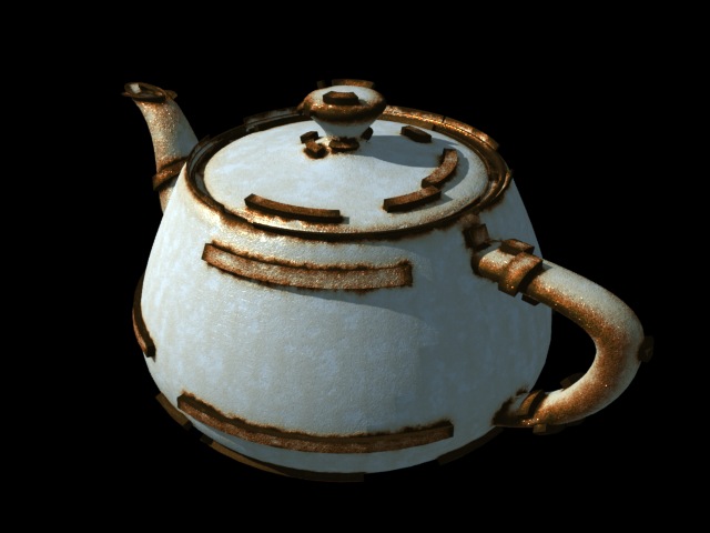

Hi guys,
Looking at this site gave me an idea:
http://www.tomcowland.com/mentalray/tc_curvature/index.html [tomcowland.com]
My implementation (btw im sure the gather stuff is incorrect/incomplete) is basically the dot product of blurred vs un-blurred normals. With some noise affecting some parms. Would be really cool to get some streaky stuff under the overhangs… but I leave that for someone who didn't think math books were for coloring in
Hip attached
cheers
S

- Serg
- 513 posts
- Joined:
- オフライン
dirty bunny
Something is very wrong with the gather setup though… for some reason the render slows down a lot if I add an illumination model to the shader. For example, it takes 24s to render just the dirt pass, and just 1s to render a lighting model, put the two together though and it takes 46s, use the dirt for bump and it takes 1m6s. Add occlusion to the lighting and it gets a LOT worse (more than 10 min)… even though the 64 sample occ pass by itself takes only 8s… hmmm
I dont get it, I've told the gather vop to import an exported parameter than I name “Normal”, nothing else.

- Serg
- 513 posts
- Joined:
- オフライン
Hi There,
Sorry I forgot to mention you must add the “refract limit” render property to your object, and set it to 1.
This is because I don't know how to set the “ray style” like you can when using the Gather call in vex language.
Ray style tells mantra that the ray is refractive/reflective/diffuse… unfortunately the Gather VOP doesnt have this option (amonst others). Besides the vop node being completely undocumented I suspect it's also unfinished.
cheers
S
