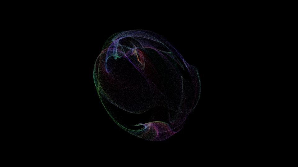

We reimplemented our tool at Houdini, excluding Pixar's pointcloud export, which is produced by another node. You may play with different Non-linear formulas, which may be plugged easily. I don't think, that using CVEX as non-linear kernel will allow to build pointclouds very fast, but you may add such features too. Good luck!
Sample scene attached.

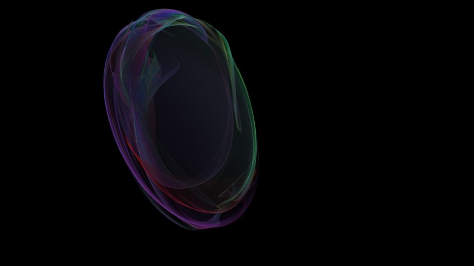

As a variation on the theme, i once tried rendering some flame fractal images and then stacked them to form a volume: http://forums.odforce.net/index.php?/topic/8471-eetus-lab/page__view__findpost__p__56247 [forums.odforce.net]
eetu.
