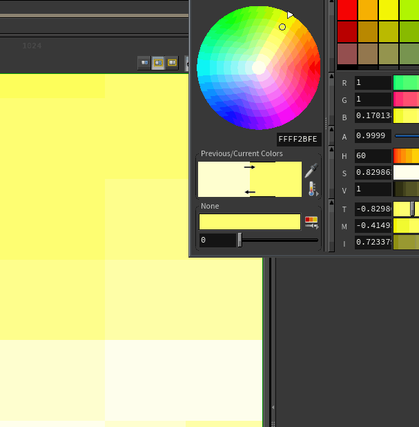

Does anyone know how to make Color Picker work with 32 bit?
4189 posts
Joined: 6月 2012
do you have an example of the issue? The color picker already works in 32bit. i.e. 0.151058 has 6 significant digits.
19 posts
Joined: 11月 2014
“Inspect” shows true values in Viev window, but ColorPicker does not accept values greater than one and less than zero(clumping).
スタッフ
5339 posts
Joined: 7月 2005
I believe the eyedropper grabs from the system screen, which has already quantized the color to 8bit (or 10bit, if you happen to be running a monitor/GPU/Window manager capable of that).
