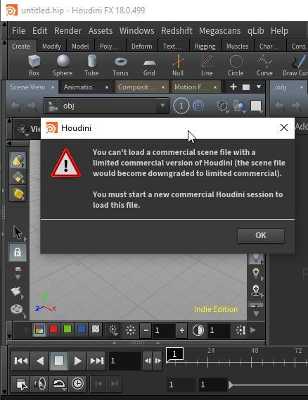

In the past (till 17.5) this worked flawlessly, now (18.0.499 and 460) i get some strange behavior. Houdini is mixing up the licensing somehow.
I start commercial (FX or core, tested both).
Server showing that i checked out a license. Houdini Info and title showing FX/core, not indie.
But in the viewport i see the “indie Edition” label in the bottom right corner.
I can save hip and hiplc files, but cannot load the hip files.
Any clue whats wrong here, it's currently mixing up my commercial scenes.

Ok i shutdown my local license server (sesinetd) restarted hserver but the only thing that happens is that houdini now shows non-commercial instead of indie.
same as before. I can save .hip files, can't open them. When i press ctrl+s after saved to .hip it switches automagicly to .hipnc.
License Administrator shows the lic in use.
any clue what could cause houdini to downgrade while running?
the network connection ist stable
as mentioned this worked super flawlessly till i updated to h18
the only thing thats new and i don't understand is the ipmask error icon, but i can't get more info from it?
no obvious errors in the diagnostic.

I've just started having this same issue this morning, was this ever resolved?
We have the Houdini Core licence, which seems to be connecting fine through the Licence Administrator, but when I run Houdini Core, I'm pushed into IndieEdition and cant open any of my hip files.
The licence server is off-site from my location, so I have not tested restarting that.
A colleague of mine was able to test on his end and he does not get the IndieEdition watermark/hip file errors.
Please assist as I have been unable to work today.

Sorry for the late answer, but maybe it still helps.
The solution on my side was a plugin/addon that was added/loaded through my packages to my houdini_path variable (I only found out later by accident). In this addon/otl folder were a few hdalc assets that secretly downgraded my houdini session.
I think the main issue was/is that houdini is showing the normal splash and not showing any message about the downgrade when it's downgrading because of scanned otls? For me it was even more complicated because i used a custom project manager which saved the files by script command and named the .hiplc file .hip. So when I realized that all my "hip" files are actually lc, i already worked quite a while on the project.
Cheers,
Heiko
