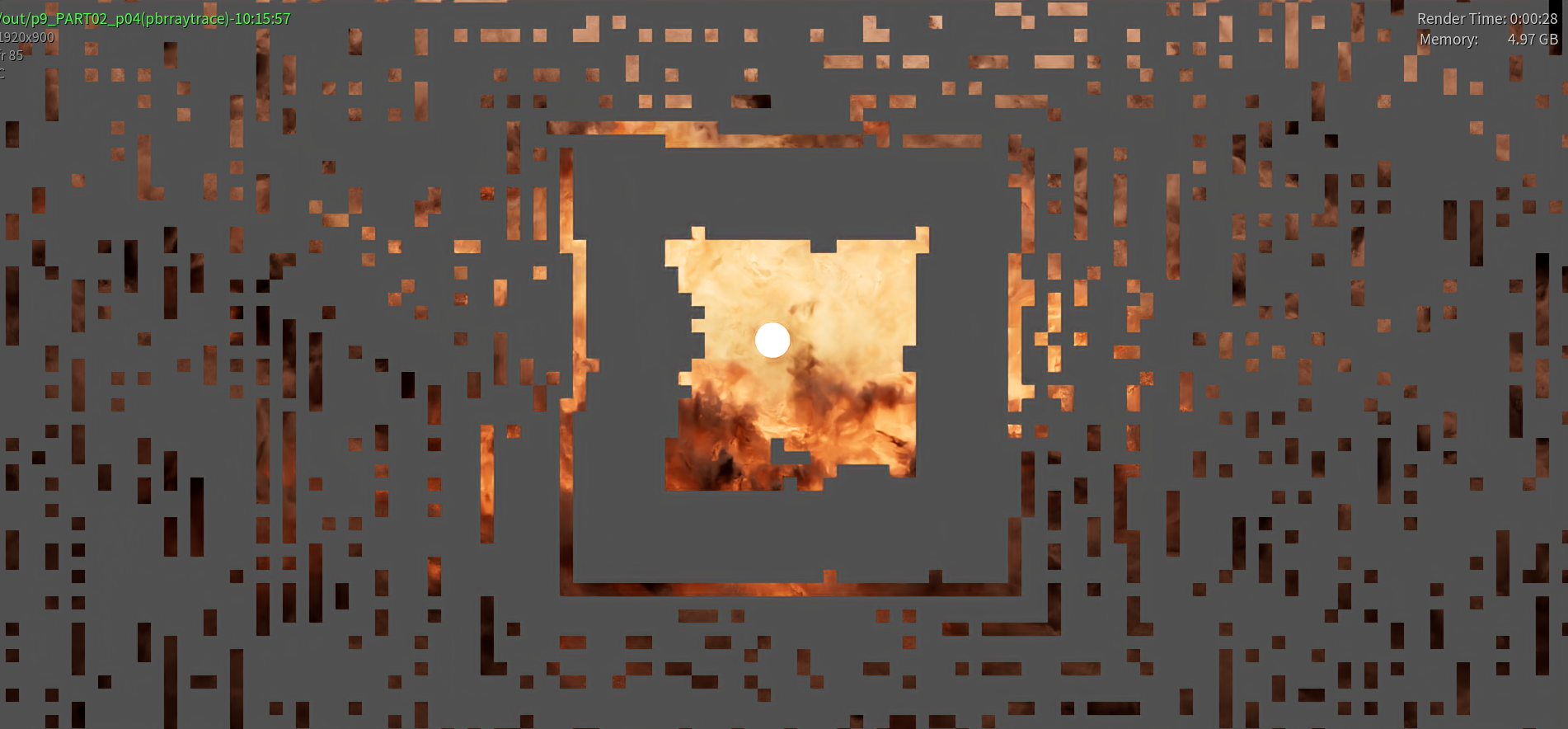

hello, when i'm rendering with intel denoiser there is something wrong. Many buckets are just grey.
I haven't this issue with Nvidia optix denoiser.
How to solve this ?

I'll submit a bug for you. The issue only seems to occur when rendering to mplay. I can't reproduce when rendering to a disk image.

Nice ! Thanks you Mark
