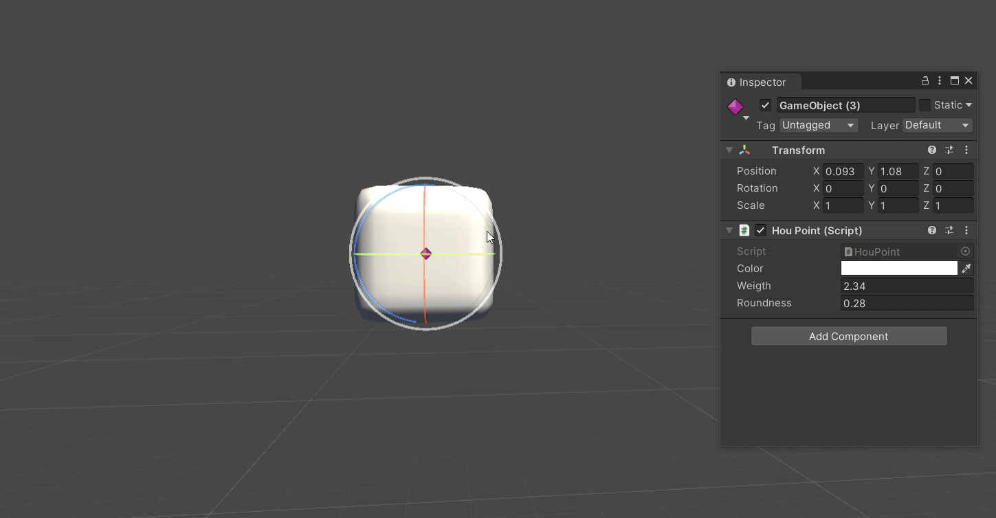

This approach also naturally translates to any game engine as point is basically actor in UE or gameobject in Unity.
For example this is the same metaball editor but loaded in Unity as an HDA:
We have the same controls and it's really easy to set up other tools like instancers, fractures etc. Points can be used as a separate input to feed some custom data about environment from game engine.
The only thing it's not available right now out of the box for UE or Unity. Though it's pretty straightforward to create a geo from set of actors/gameobjects.
