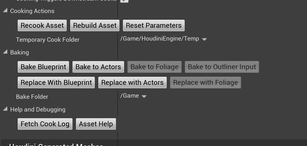

This may or may not be related, but how are these buttons supposed to work? I clicked "Bake to Outliner Input" and now it is greyed out and I can not unclick it.
Screenshot 2021-09-01 132919.png (53.8 KB)

Note to self: The 4.26-v2 version of the houdini engine plugin is the one with all the bells and whistles. I got my beloved button back.
