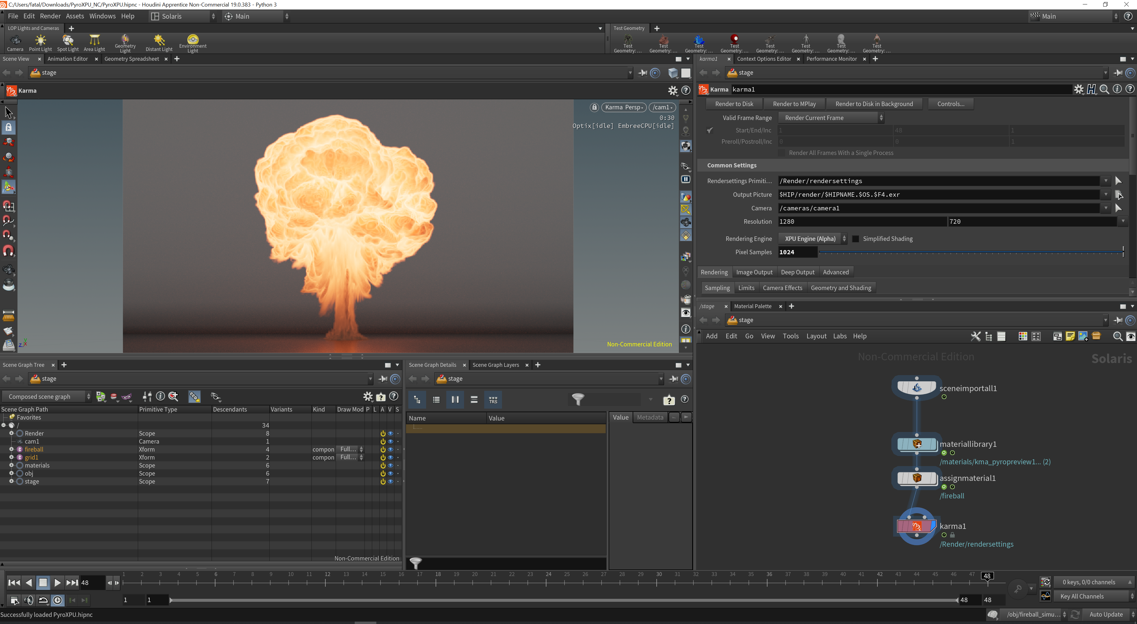

Did anybody do a pyro test with XPU?
In the Houdini 19 HIVE presentation Adam Swaab shows how to render pyro with XPU which is by using the new pyropreview material but I can't make it work.
Any ideas?
You need to convert all Houdini volumes (Density and Scatter at least) to VDBs with Convert VDB node.
Yep that did the trick. Why didn't I think of it before.
Thank you very much!

I've made one frame pyro scene for testing.
Nvidia 2060 super
XPU:0m 30s
ACES color space is enabled.
Maybe I had to do something heavier :S
Edited by FaitelTech - 2021年10月31日 09:41:36
PyroXPU_NC.zip (5.7 MB)

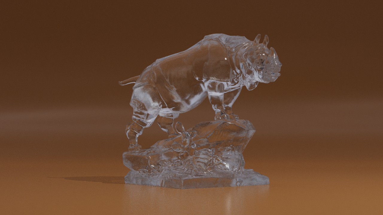

The Rhino Scene:
Karma CPU was taking too long for me to wait for it. It said the ETA was 2 hours after waiting for 10 minutes.
Karma XPU: 06 minutes 45 seconds
Pyro Scene:
Karma CPU again couldn't wait for it to finish, was stating that it will take 35 minutes.
Karma XPU: 39 seconds

Hey @GCharb, could you export an abc of the rhino to compare in other softwares/renderers ? Thanks

lucas195ec7cc0d984f4a
I made the scene in Apprentice, and Apprentice only exports OBJ files!
The model is a 3D scan of Alfred Jacquemart's rhino scupture, easy to find online!
