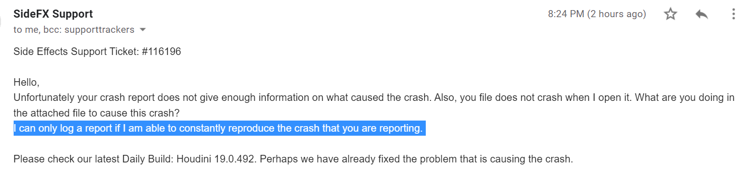

Unfortunately, it doesn't work for me. I've set the registry, but when Houdini crashes, there is still no crash dump at all.
Edit: I contacted the support, and they explicitly stated they won't log the crashes that they can't constantly reproduce. I guess I'll just stop reporting crashes. (and stop migrating my workflow to Houdini...)

What are you expecting them to do to solve the issue, if they cannot reproduce it?
It could absolutely come down to your hardware, OS, and what you are doing.
Linux does have better logging, but what verbosity level are you setting houdini to?
What is the DSO error level set to?
If they cannot repro it, maybe you can post it here, with steps that you take to create the crash?
So far I haven't seen you list any of the steps you are doing to create the crash, if you could list them,
and supply the hip file here, we can all try to repro it.
