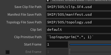

3. Right now I have to manually fill all of these fields by hand. Yes I can create path presets but if there is a way to have this node to be included to a FIleCache somehow? What's the approach for that? I think we need a tutorial.
4. How do you actually cache this node? I tried to pass it to top rop fetch but it failed. Do we need to use lop file cache after it, if so, why do we need to recreate the output path in the filecache node if we already have it in the geometry sequence, it's very confusing

Geometry Clip Sequence authors the value clip in memory, like all other LOP nodes. It is not a ROP, as it never writes anything to disk itself. It requires a separate node (like a USD ROP or a File Cache LOP) to cause the value clip to be written to disk.
Value clips involve creating a number of separate USD files. None of these files are "active layer" (the layer to which the value clip metadata is written). It is this active layer that is controlled by the Output File parameter on the File Cache LOP.

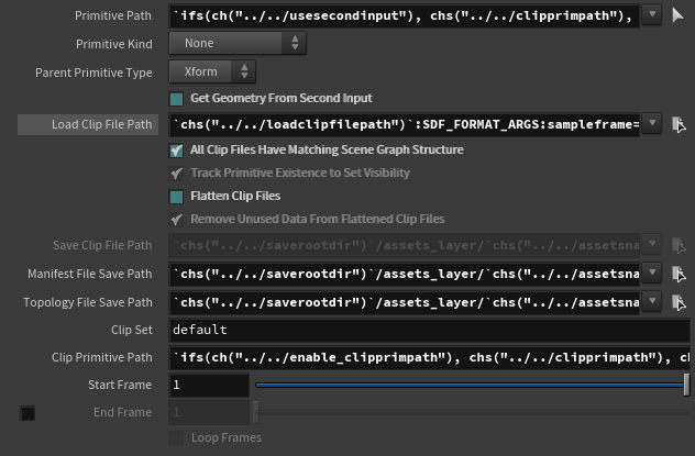

I did some tests on storing valueclip, using the 20.5 version of the geoclipsequence node.
This is the problem I encountered many times in my tests:
If you directly use an existing file (bgeo or vdb) to link, when loading the valueclip, all the linked files will be read once before refreshing the data in the window.
Only after turning on Flatten Clip Files and regenerating the existing geo into a usd file, the read valueclip file can be read correctly according to the corresponding frame number. It will not read all the cache at once.
The same problem occurs when using sublayer and reference nodes
It is recommended to use a large cache to test, so that you can intuitively see that the hard disk reading speed is completely different.
I have also tested it on many machines and with the 20.0 version.
Is there any other way to solve this problem?

Have you tried turning on the (relatively new) "All Clip Files Have Matching Scene Graph Structure" parameter? Enabling this option should prevent the geo clip sequence LOP from having to open all the clip files in order to author the clip data (it normally has to check all the clip files in order to build the manifest and topology files). Turning off "Flatten Clip Files" (if you know this step isn't necessary, as it would not be for BGEO clip files because they don't support composition) can also help improve the performance of this node.
But to work this way, you are responsible for ensuring that the scene graph structure is not changing over time and that the clip files don't need to be flattened.

Yes, I have taken care to ensure that these problems do not occur, the scene graph structure is not changing over time, the problem still exists
