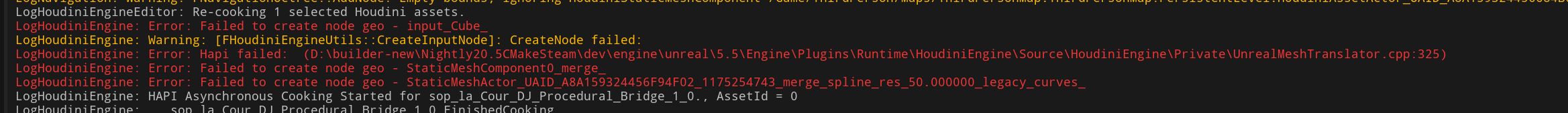

I've been looking around and can't find an answer to my problem.
When I import a HDA in unreal, Houdini engine syncs just fine, but anything else I get an error and the model doesn't sync.
I am building a HDA where I am using various collision objects from Unreal, and these are of course not registered by Houdini engine.
I'm running Houdini indie 20.5 latest build from Steam and unreal 5.5
I've attached a couple of screen shots here.
Joined: 10月 2018
There is no problem in Houdini 20.0.547 and unreal 5.3.2.
I would really love to know if this is a local problem or if anyone else has this issue.

I'm having the exact same problem after debugging a project for a client, I found out that houdini engine with houdini 20.5 and unreal 5.5 just doesn't work.

Ok I might have found a fix, I reinstaled the engine, houdini and the plugin.
Them backup your pref folder in the docs (the houdini20.5, where your otls live and everything)and delete it so houdini creates a new one when you open it.
That did the work for me!
