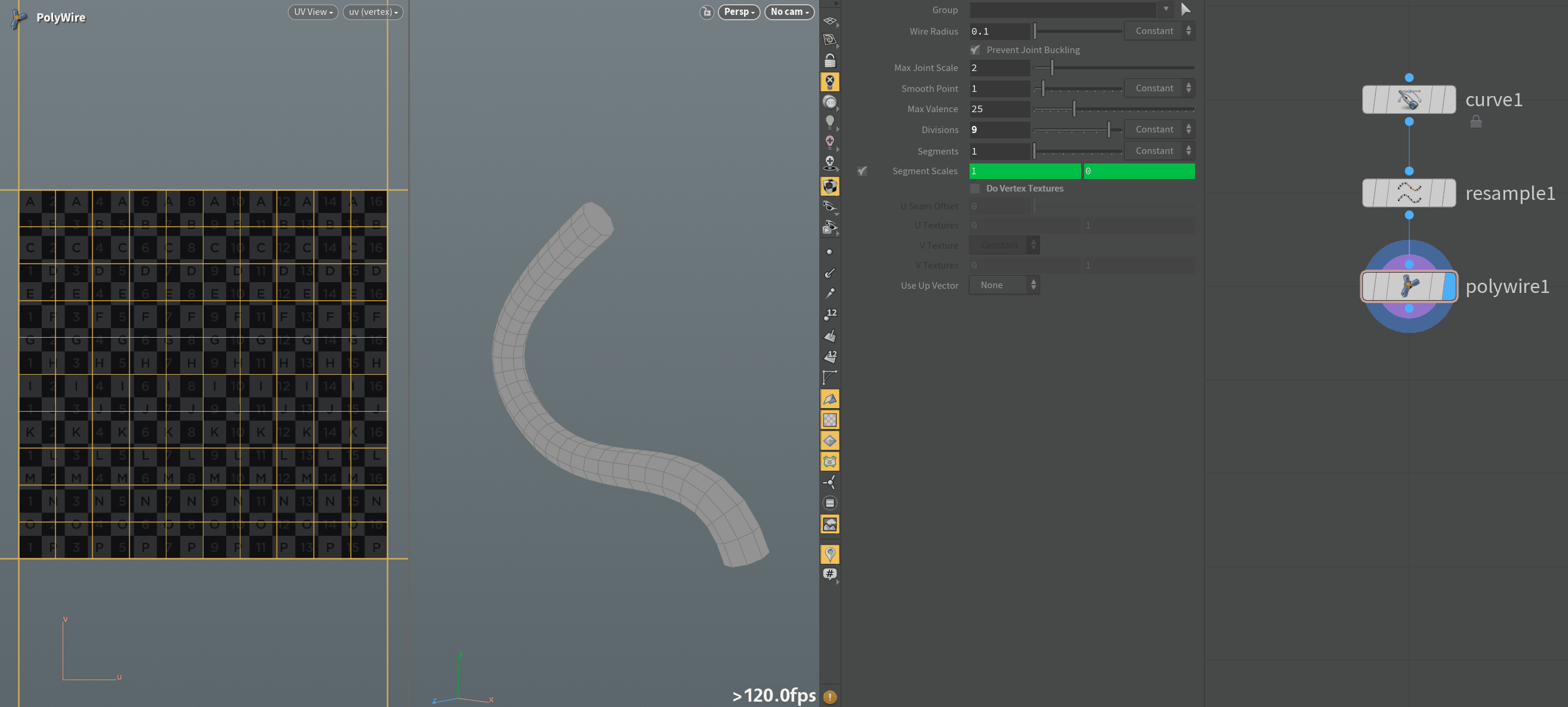

504 posts
Have you tried labs uv-transfer?
Input:
1.any spline like object
2.corresponding spline
create a clean sweep from the spline with uvs and use uv-transfer.
uv_spline_transfer.hipnc (285.3 KB)
185 posts
Joined: Aug. 2013
Aizatulin
Input:
This is quite handy. Thanks!
504 posts
Sure
It can be done in VEX aswell (without uv-transfer) using an orientated spline. The uv-coordinates can be extracted from the (xyzdist) captured values.
uv_spline_transferA.hipnc (298.3 KB)
