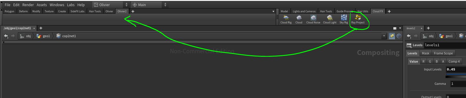

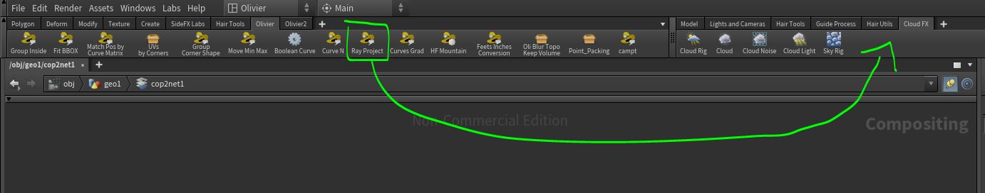

Here are the steps for anybody needing it. Lets say I want to move my "Ray Project" tool from the tab Olivier to Olivier2, I need to:
1. Left click-and-drag the tool into another temporary Shelf Set Tab. (in this case, I'm using the Cloud FX tab).
2. Left click-and-drag the tool into the desired Tab (Olivier2)
3. Magic!
Thanks for the help!
-Olivier
