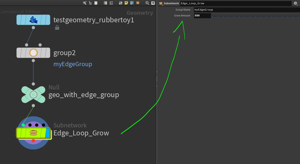

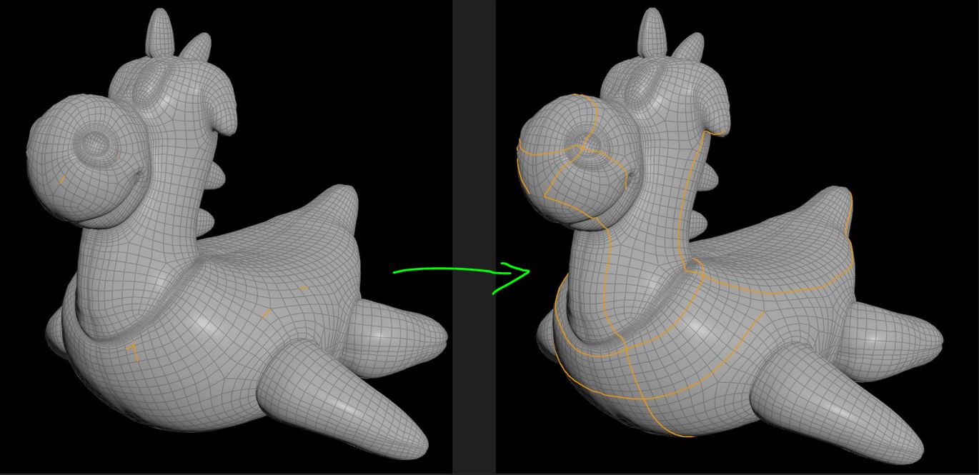

Hi!
I could not find a tool to grow edge loops so I build one myself. If anybody needs this, take it! (link below images)
My method was to:
1. Promote edge group to points
2. find the ends of each current edge loop
3. With half edge functions, add each next points to array
4. create a string from the array to use in the group sop (e.g. "p0-1-25-64-8 p35-4-3-78")
Edited by olivierth - May 17, 2025 16:00:38
EdgeLoopGrow_01.hipnc (283.2 KB)
-Olivier
