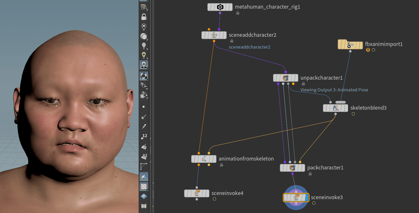

Ahah ! it was the mapping and trial and error, but indeed this is the node you need , thank you and once correctly setup it all lines up nicely and animates directly from the FBX animation file - which includes skeleton animation and shapes
just finishing off the blendshape mapping list - theres a LOT of remapping and its changed again since you wrote the last snippet Edward, Brow name did at least
Edited by Rob Chapman - Oct. 5, 2025 18:42:47
- Rob Chapman
- 64 posts
- Joined: July 2013
Oh! it seems the add animation from skeleton node fails on more complex nested rigs.. like the metahuman head skeleton.
so still the simplest way to put fbx back onto the head rigs at least is to unpack and repack and animation from skeleton works on body still
Edited by Rob Chapman - Oct. 7, 2025 13:19:40
