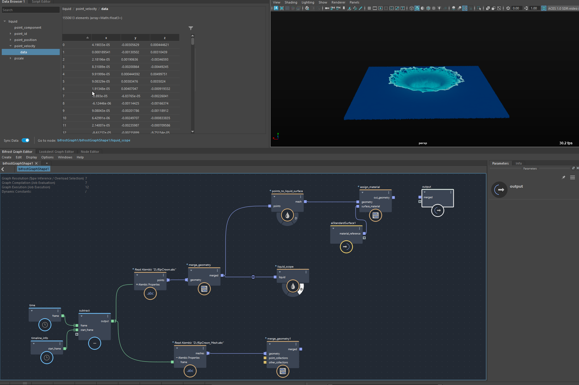

Sorry just busy I did a quick video here showing the process.
I just grabbed the shelf crown preset and I save a few frames as an .abc load them in Bifrost and as you can see v@v gets converted to point_velocity automatically. You can either save the point cloud in Houdini as an .abc or .vdb points and load it and you could do the meshing inside BF for more control so there is not back and forth or bring the meshing directly as well up to you.
You can also manipulate any attribute btw, like completely override it or multiply, add, etc

I downloaded it earlier, but thanks for sharing the link as well. I'll test it out more tomorrow, but for some reason the cached mesh disappeared in the render, but the points workflow rendered perfect. I'll try tweak some settings to see why the mesh alembic wasn't rendering. Lastly, since I'm not experienced with bifrost I'm no doubt doing something wrong in terms of the aistandard shader, I tried playing with the colour in the attribute editor but it stayed grey. Is there a trick to working with shaders in bifrost?

you either can use the standard_surface inside the graph (for more basic stuff) or if you have a complex network you need to drag and drop the the material from the hypershade inside the graph and use an assign material node in BF, if you want to use an attribute for color, etc use the userdata nodes for that.
