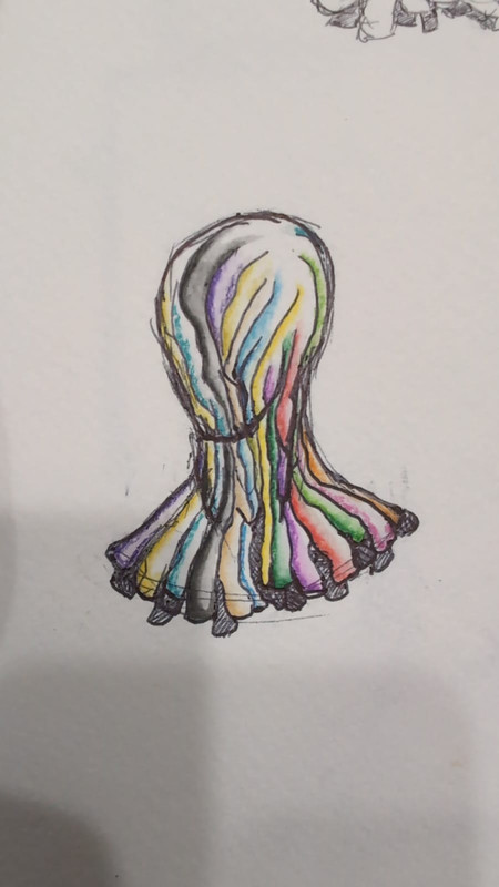

This is what I wanna go for;

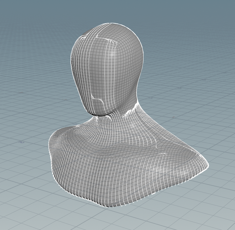

This is where I am at -
I am trying to use find shortest path.
But some points in the mesh are being left behind. I want to cover all of them going downward.
I have also tried using for each loop, to experiment.
Clearly need some guidance or tips.
Am I working on the wrong thing to achieve my goal?
Is there something else I should try?
Would love to hear any inputs!

447 posts
Here's a different approach using Boolean Shatter and then converting the seams to curves:
XtryX 02_shatter.hipnc (463.1 KB)

Okay, so this is what I realize.
I want to simulate growth downward on the surface.
This might seem way beyond my limits. But I still want to attempt it.
To achieve the look I wanna go for.
I would love any hints or guides.
Wish me luck or guide my journey my good friends.
ps- I can totally sculpt this. But in the spirit of Houdini and its madness, I persevere.
