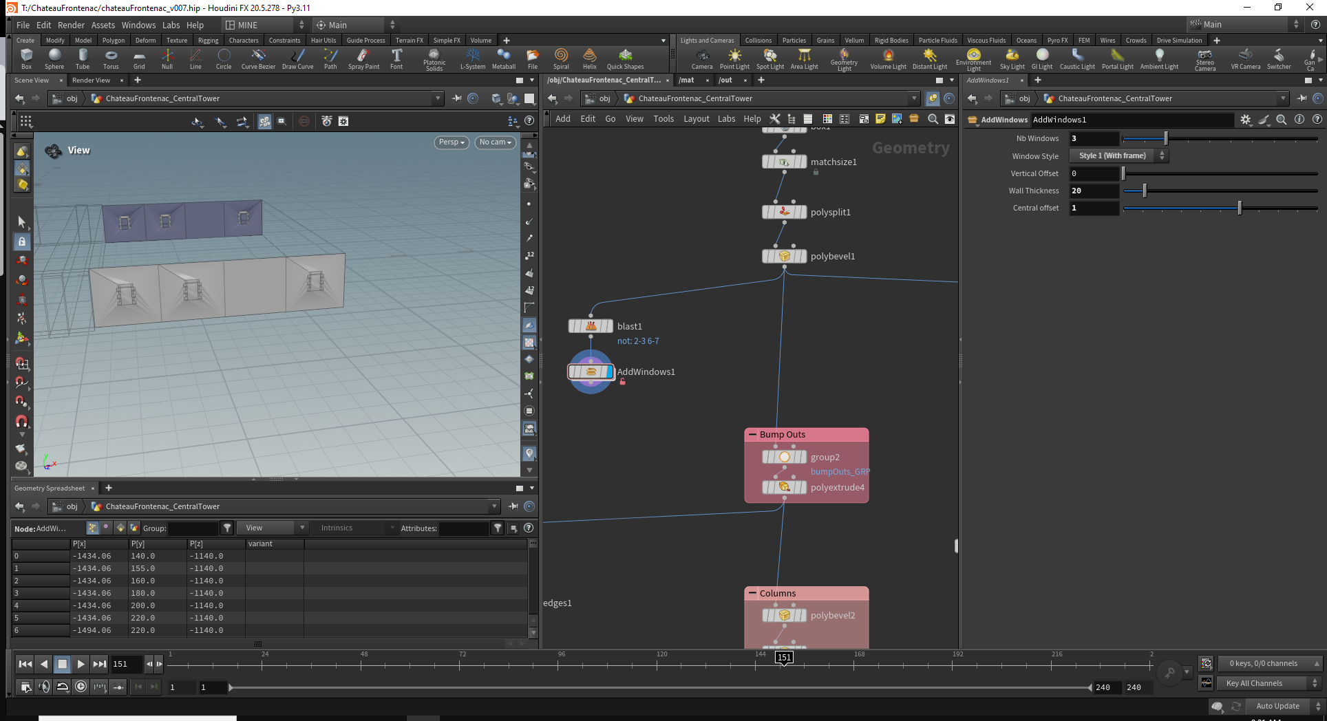

I'm making a little Digital Asset that adds a variable number of windows to a primitive. I do this by adding segments to the primitive, creating central points for each segment and using copy to points to place my windows. This works great.
I recently added a parameter to add empty segments on either side and I used an attribute wrangle to simply remove the extra points. It works, except when I want the rightmost space empty (centerOffset = 1), because when I create a central point for each wall segment, the rightmost one isn't the last one as one would expect.
I could cheat it, but I would rather find an elegant solution to this problem, so I'm open to suggestions.

Thank you BabaJ for your answer. I removed all the irrelevant stuff from my file, so I hope my files can be useful, as you suggested. For simplification's sake, I am simply adding a box in lieu of the window, and some parameters for my asset have been removed.
To see my issue, swap between -1 (correct) and 1 (incorrect) for Central Offset on the AddWindows node. Values of more than 2 are also correct.

The culprit is the Edge Divide SOP. So you can just sort the primitives to get them to be ordered properly:
