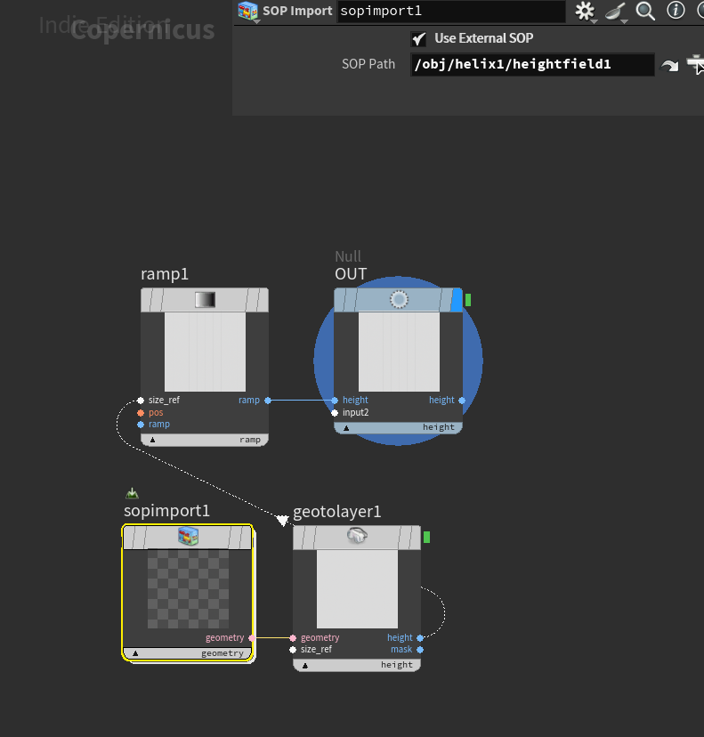

I watched the video too (just to know) as i understood you got to do this ;
..or maybe their is a better solution !?
Edited by Benjamin Lemoine - Sept. 5, 2025 05:51:16

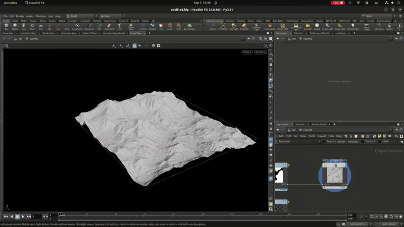

OK guys - thanks for the input - I'm putting this down to a 'Copernicus glitch'...
I opened the same file this morning - and the heightfield visualise showed on the X-Z plane (Y up) as expected! It was definitely stuck on X-Y (Z up) yesterday. Bizarre!

Hey! I believe this is the issue you are facing. For now Viewport gets a bit confused if you 3d transform your height in Copernicus, I believe this is a known bug. The simplest fix to that is to just restart your viewport or use Labs->Reset Viewport. Hope that helps and have fun!
