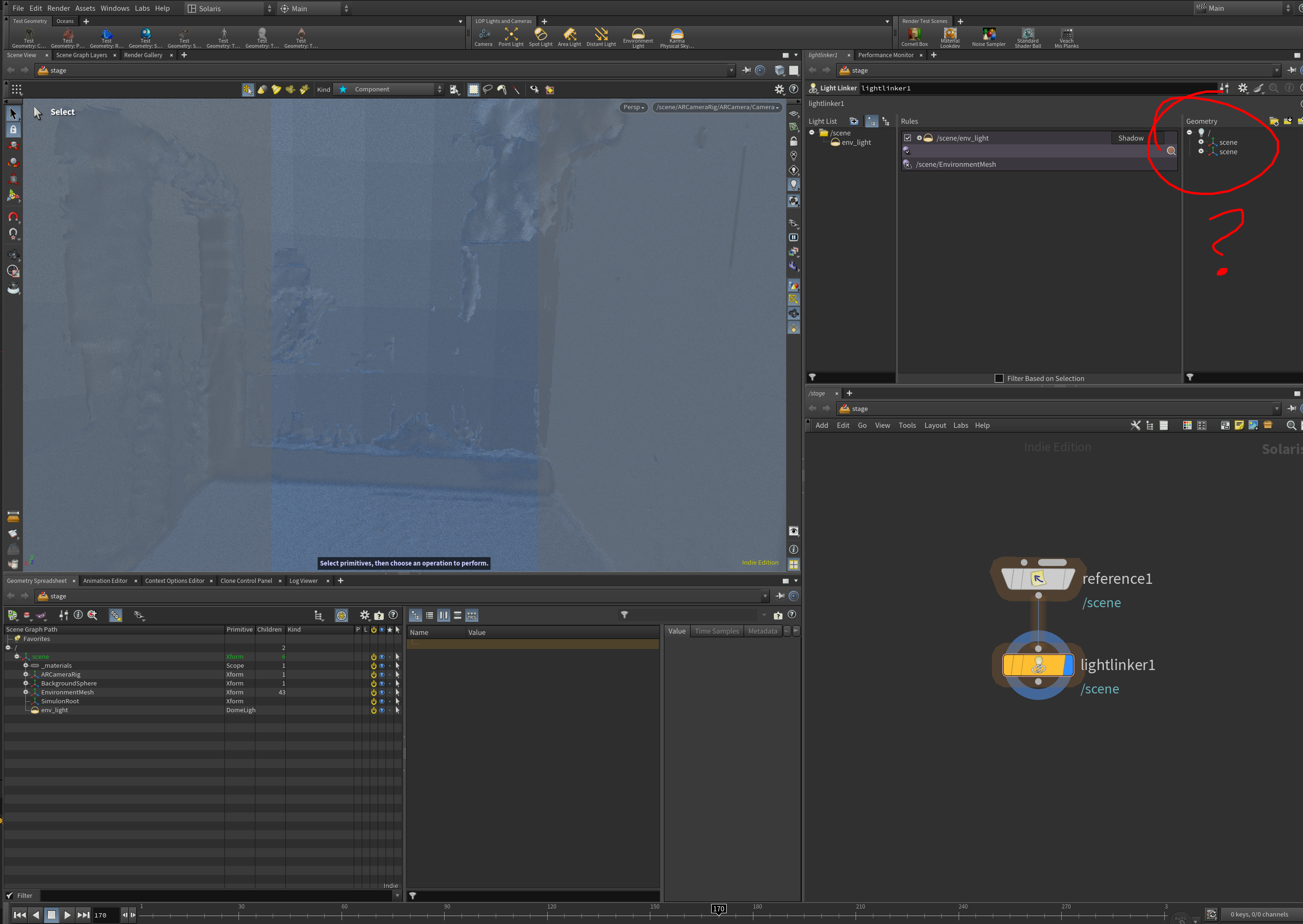

Hey guys,
First of all, I just started learning Karma so I might not be expressing myself in the best way possible since I'm not really sure what's going on here
Right now Im having an issue importing a USD file using the Reference node.
It kinda works, but it's messy, so I assume there might be a way to tight things up
Here's what's happening:
Im importing a USD (exported from Blender) that have all features from a scene.
So it have an Environment Mesh with materials, an env_light and a camera
On my Scene Graph everything looks organized enough.
Now I need to use the lightlinker to make the env_light ignore the environment mesh, but as soon as I add the node I can see it has 2 scene roots in there.
Why? Why do I have 2 scene roots in there?
The scene is not working properly so I figured out this might be a good start on understanding how to make everything work on the most optmized way possible
You can download the hip with the the asset here [www.dropbox.com] if you wanna have a look at it
Thanks!

What version of Houdini are you using?
I think this was a bug mentioned somewhere on the forum earlier. I can't find the post now tough :/
Anyways it works as expected with the Houdini 21.0.512.
Edit:
I tried 21.0.559 also. It has the same issue as you mentioned.
Daily build 21.0.595 it's fixed.
Edited by Heileif - Jan. 14, 2026 22:09:59
22 posts
Joined: Dec. 2015
Hey Heileif,Im on 21.0.559
Ok, great! Thank you
