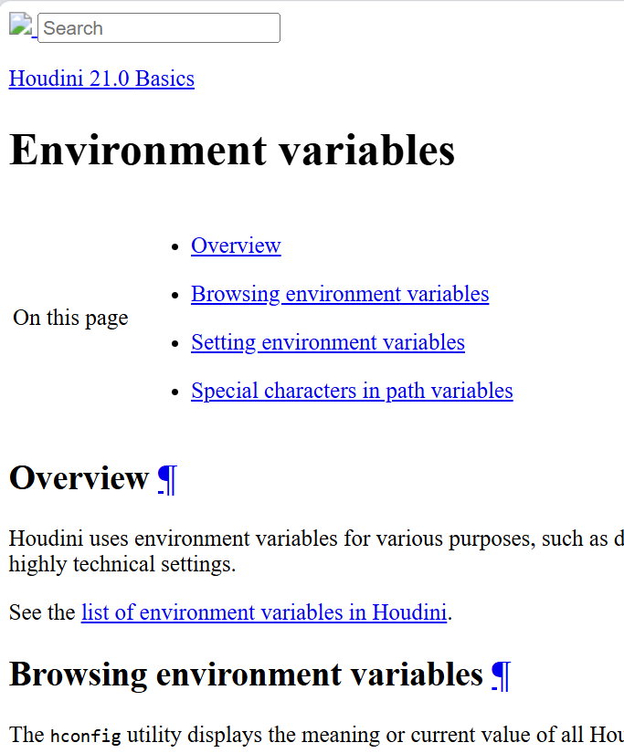

Thank you. But I tried
hhelp generate [DIRNAME]and it only generates html without css/images, making it pretty much non-human-readable.I checked the doc: https://www.sidefx.com/docs/houdini/help/central.html [www.sidefx.com]
But it's very confusing. It says:
First, set up the directory structure as in setting up central server directories.
without mentioning how.

Is it bugged on Windows? I ensured that these directories exist. However they're still empty after I run
hhelp generate fileshhelp generate filesdoes generate the html files and many directories. It takes quite a while. But it doesn't populate icons, images, videos etc for me. These directories are still empty after the generation finishes.The html files are correctly generated and they do expect the image files to be in images:
But there is nothing.
Edited by raincole - March 3, 2026 02:04:51

johnmather
Have you tried extracting $HFS/houdini/help/images.zip into your newly created images folder?
It works, but
1. Is this really the 'official' way? Feels very hacky. The doc [www.sidefx.com] doesn't even hint that one needs to be aware of
$HFS/houdini/helpto serve static help files.2. Where is the css files? I checked the html and the css files are supposed to be in
staticfolder, but there is no $HFS/houdini/help/static.zip or something similar as far as I can tell.
