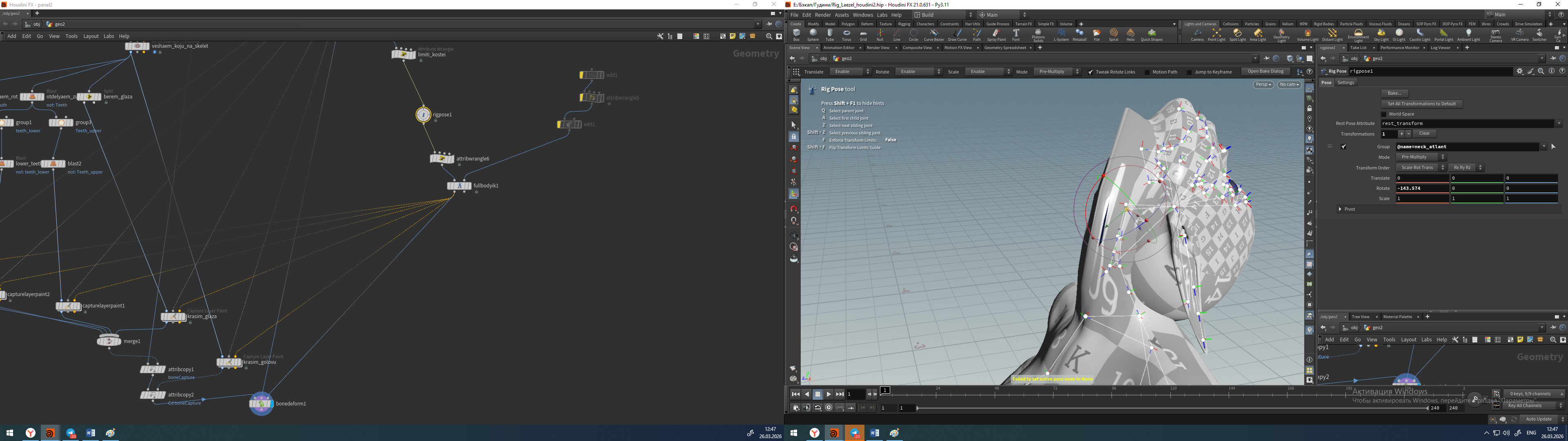

Pretty late to this and for posterity, this is in the houdini docs for Rig Pose:
Enforce Transform Limits
When turned on, if your skeleton has any joints with defined rotation joint limits (as set up by the Configure Joints SOP node), then you will not be able to rotate those joints past their set limits when posing your skeleton with the Rig Pose handle in the Rig Pose viewport state. See Rotation limit handle viewport state visualizations for a demonstration of this behavior. You can also turn this option on/off per joint with the F hotkey.
You need 1 of the 2 nodes below before your rigpose:
configurejointlimits
configurejoints
Displayed in the viewport help, you can then hit F or shift + F to flip the limits
Example:
Edited by AntonMoss - April 13, 2026 21:42:59
