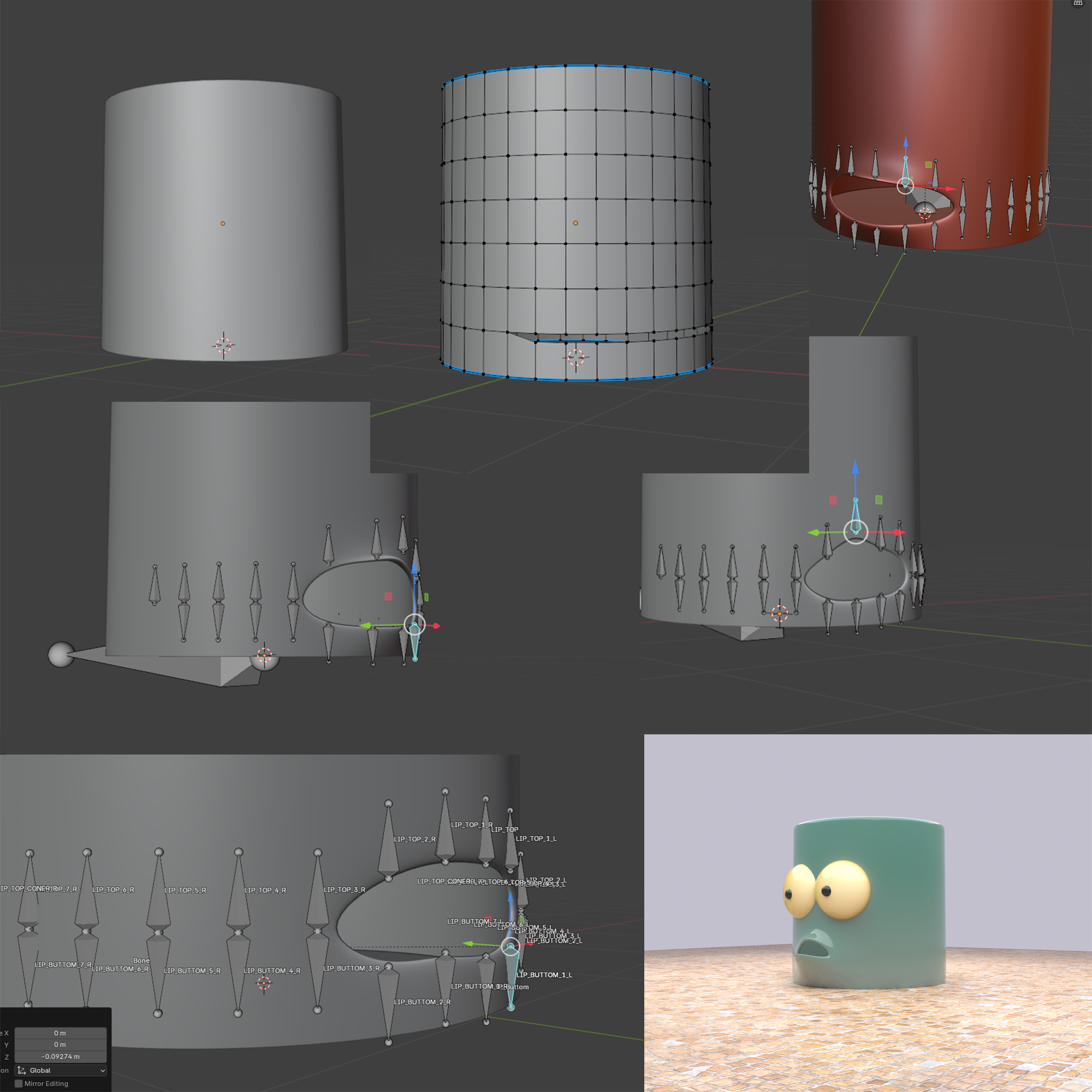

I am developing a high-end, flexible lip rigging system in Houdini 21 using APEX. I want to move away from static bone chains and create a fully procedural, curve-based solution.
The Goal (as shown in my Blender screenshots):
I have a cylinder with procedurally split edges at the mouth area. I want to implement a system that handles the following natively in APEX:
Curve-to-Joint Binding: A system where a curve (or multiple curves for upper/lower lips) drives a set of joints. These joints should be constrained to the curve points.
Dynamic Procedural Welding: Similar to the Blender Weld modifier, I need real-time vertex welding within the APEX graph. When the upper and lower lip joints approach each other, the mesh should seamlessly seal.
Advanced Lip Roll: Each joint along the lip curve needs a Roll (rotation) attribute to simulate the lip rolling in/out, which should be easily controllable via the curve’s tangents or custom attributes.
Procedural Density (Variable Controller Count): I want to be able to change the number of controllers (and joints) on the fly. For example, switching from 5 main controllers to 11 for finer detail without breaking the skinning or the APEX graph logic.
Sticky Lips / Seal: Logic that allows the lips to "stick" together within a certain distance threshold before they finally snap open.
My Questions for APEX Experts:
What is the best way to implement a Curve Constraint within an APEX Edit Graph to drive joint positions?
How should I handle the Lip Roll logic procedurally? Should I use an Orientation Along Curve approach within APEX?
Is it possible to make the Joint Count a procedural parameter that updates the APEX Rig Graph dynamically?
How can I implement a Distance-based Weld/Fuse node directly in the APEX evaluation to ensure the mouth seals perfectly when closed?
I'm looking for the most robust, "production-ready" way to set this up in H21. Any graph examples or node suggestions would be invaluable!
