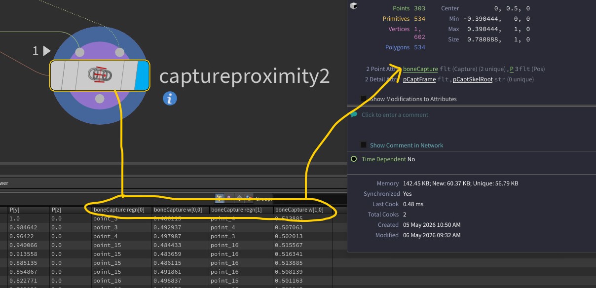

I wanted to edit an attribute from the Capture Proximity Sop called boneCapture. in the Geometry Spreadsheet, I can see what looks like 4 attributes:
boneCapture regn, boneCapture w, boneCapture regn, boneCapture w
...but if I middle click on the node, it says its a single attribute named boneCapture. How do I access its values in a wrangle to edit them? its not a float, not an array... what is it?

it's an index-pair attribute
you can unpack it to more VEX friendly set of index and data arrays using Capture Attribute Unpack SOP [www.sidefx.com], edit and then pack back using Capture Attribute Pack SOP [www.sidefx.com]
