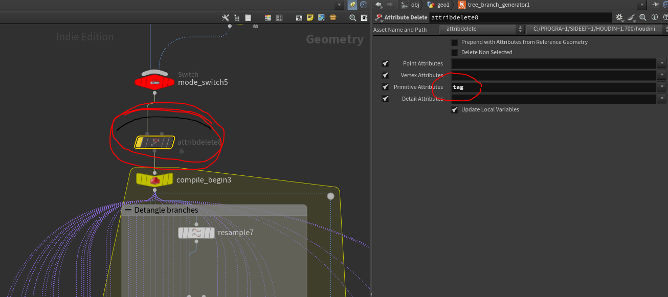

I'm not sure where to pose SideFX Labs bugs - I don;t see provision for that in the normal bug report page
It's been a couple of years that I've noticed this issue with the "Labs Tree Branch Generator" but I always just fixed it while I used the node then moved on. But given that it's still there currently, I think it has to be brought to notice and fixed for everyone.
The "labs Tree Branch Generator" has an attribute delete node that removes the "tag" attribute from the whole HDA. I have attached an image showing the node in question. So unless it has some other purpose that I don't see, it doesn't need to be there
NB:And then for the Labs Tree Trunk Generator, the tag attribute as added to primitives instead of points. Not also sure why

tag delete.PNG (130.2 KB)

Posting here the final solution to this issue for future reference
From SideFX support
I've updated Labs Tree Trunk, Tree Branch, and Tree Leaf Generator SOPs to apply the tag to both points and primitives. So if someone wants to choose between points or prims for the tag, they have both options.
