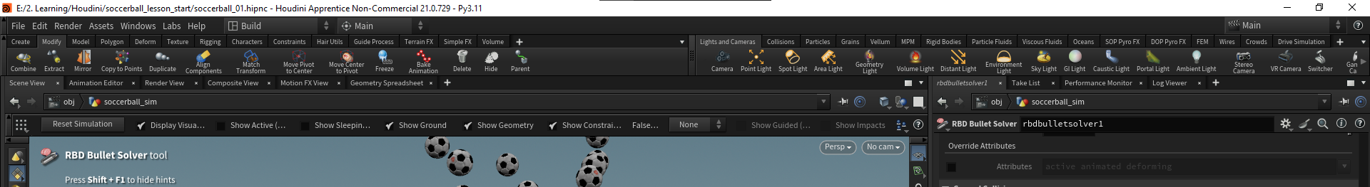

I would like to have the option to make the whole UI full screen like blender
like this
I want top white bar removing feature that makes the software fully full screen, cause that white top bar is taking space that isn't necessary that is taking too much space.

If you are not on macOS, fullscreen is not officially supported:
https://www.sidefx.com/docs/houdini/news/19_5/viewport.html [www.sidefx.com]
But there are workarounds using Python Qt which I use successfully for years:
https://www.sidefx.com/forum/topic/53236/ [www.sidefx.com]
You can see fullscreen in action here:
