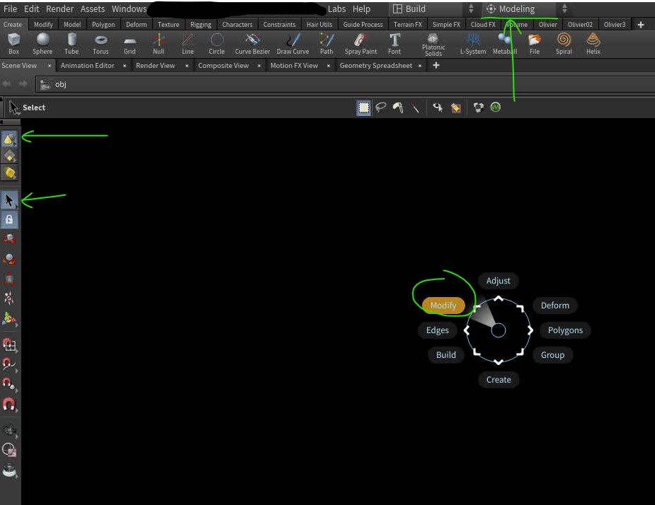

ahh! ok, found it!
First, I press S in the viewport to activate the Select mode. On the upper left side of the viewport, you have to make sur the arrow is black (not white). If white, click on the Object Select Mode just above(yellow cone and grey sphere icon). Then, make sure you change the Radial Menu at the top to Modeling.
In the viewport, after selecting your geo, press C and go to Modify -> Duplicate.
